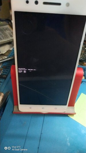

Status.

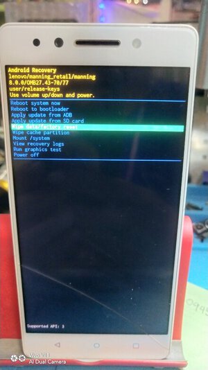

do a hard reset volume up and power switch together
hanggang lumabas ito
scroll to RECOVERY by using volume up
power key to select
hanggang sa lumabas ung android logo
not my image nakalimutan
credits to the owner
sa ganyang status
press volume up and power key
kailangan sabay para pumasok sa next image
use volume up and scroll to wipe data/factory reset
power key to ok or select

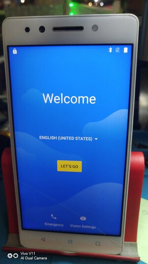

then reboot system

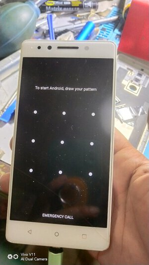

may frp pa

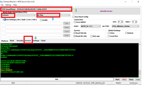

open CM2MT2 and set follow image
(select K8 Plus dahil walang K8 Note)

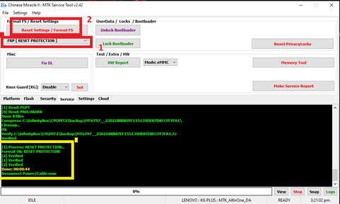

follow image to do FRP reset
power off phone and insert usb (no boot key needed)

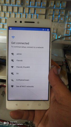

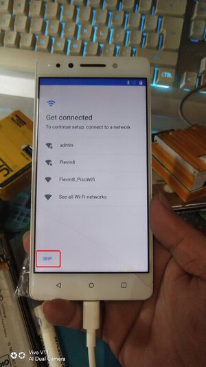

may skip na
complete set up

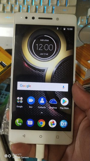

Done!!!
