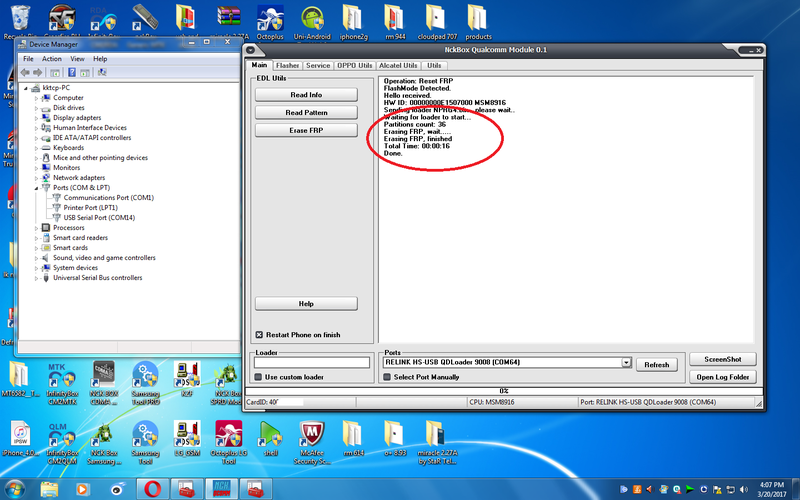

procedure..
open nck activated
select qcom
main module tab
push vol up +vol down sabay then salpak usb
hintayin madetect
select comport(RELINK HS USB QD LOADER)

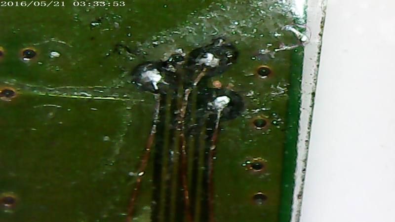

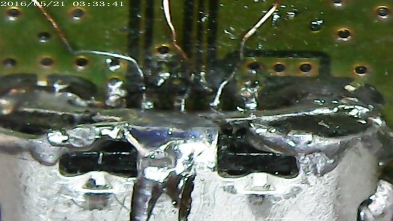

kaso tong tanggap ko putol 3 lines kaya jumper mode pa done!

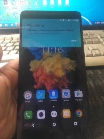

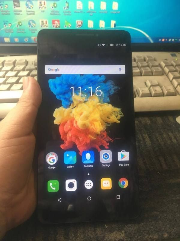

done nakuha sa tiyaga!
