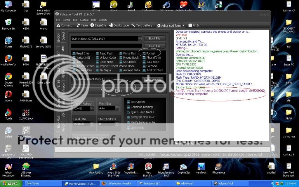

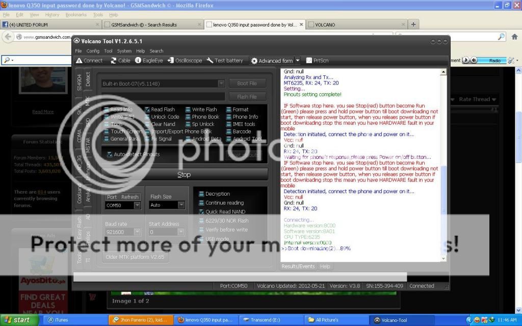

1. Buksan ang unit
2. solder rt tx pin out
3. Connect to PC and open volcano
4. detect pin out

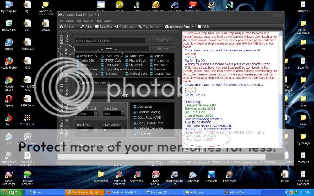

5. select MTK tab and choose right boot
6. check click info then click run press power on
7. check read flash then click run press power on
Problem Hang
Click Info
Read Flash
At Ipasok Ang Na Read Na Bback Up & Format Flash & Run

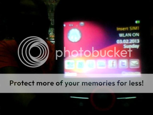

Done >:D<
