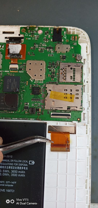

share ko tonq nagawa kong water damage tablet lenovo....
sbi ni tumer tumutunog pdw at nagvvibrate........tsek ko my power at my display kaso no lights!
kya baklas unit nakita ang salarin sa lcd connector..........

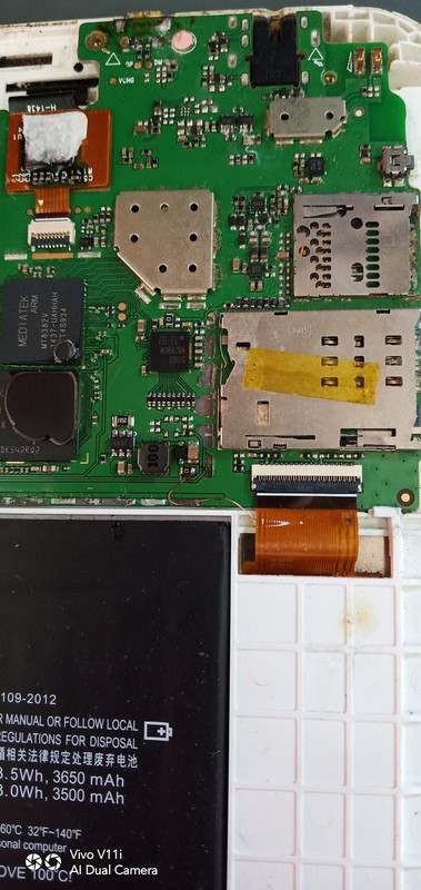

kya need jumper kze nabulok yung hinangan ng ilaw xa lcd connector....
see pics:
jumperways ko!

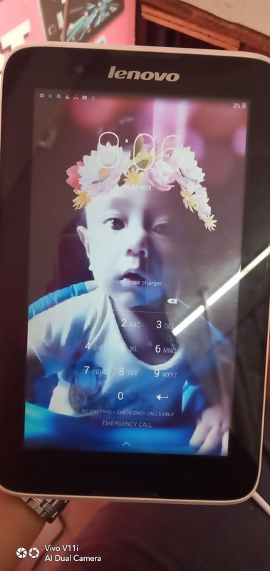

result ng basic moves hehe
see pics:
jumperways ko!
pic uploading siteresult ng basic moves hehe
