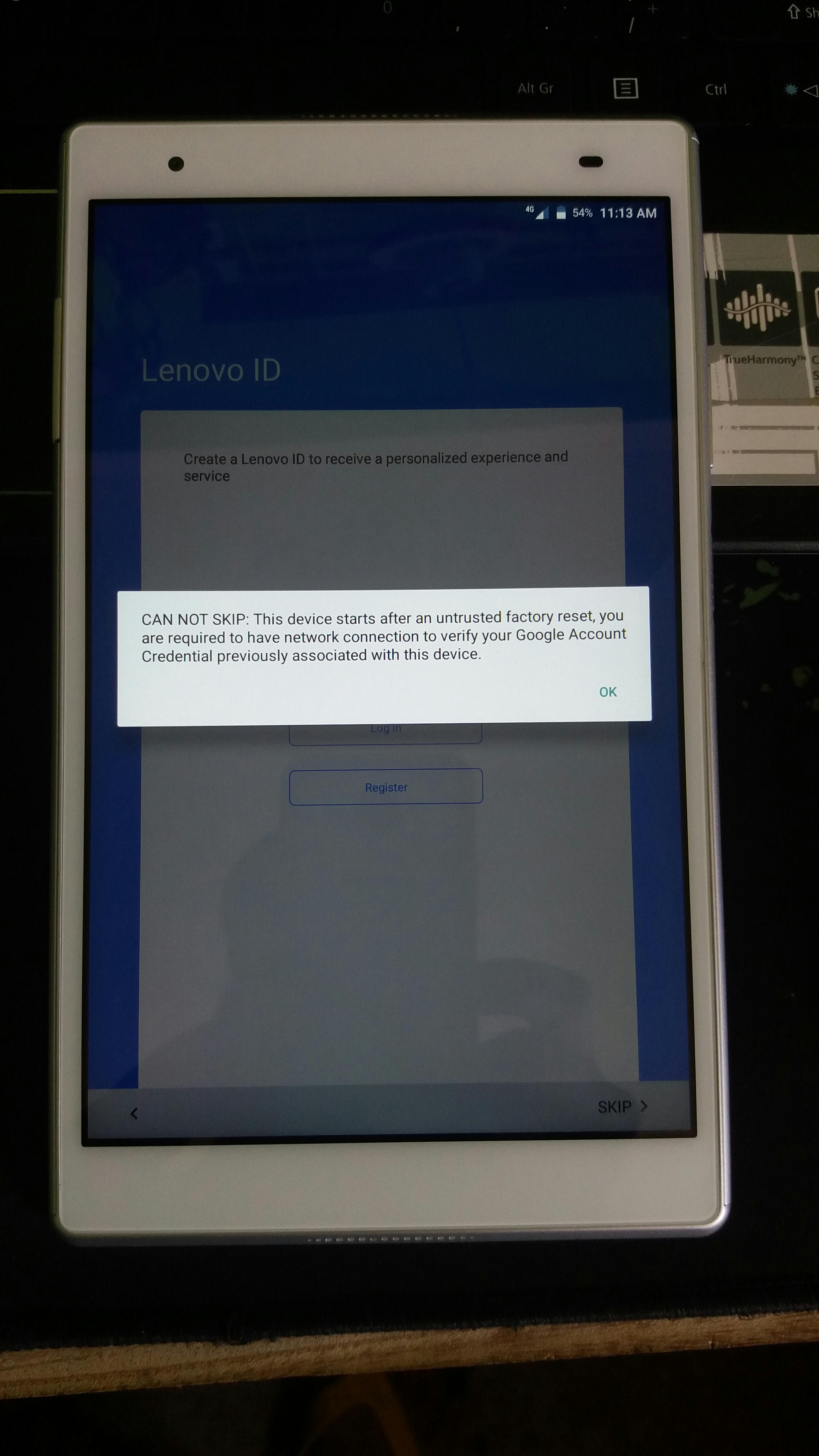

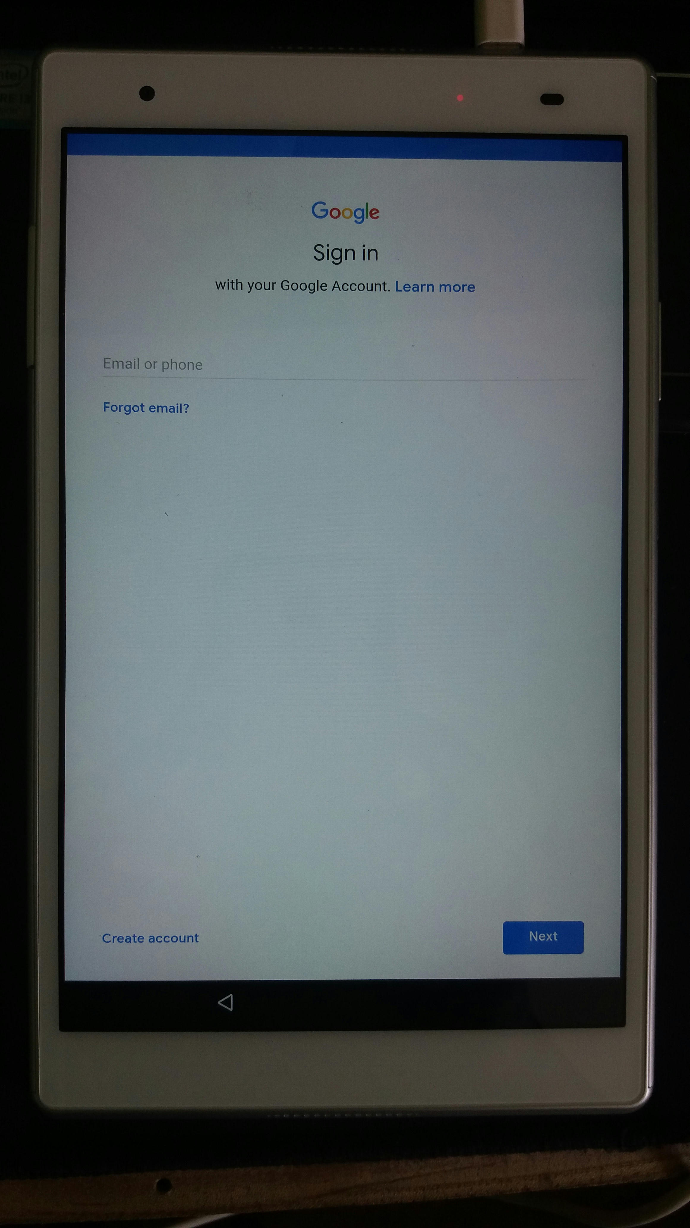

Phone History Galing ibang bansa pagdating d2 sa Pinas ganito na po ang Unit Block by Google account..

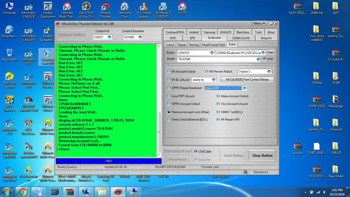

Open Miracle Thunder
select qualcomm Tab
then click again extra tab
select brand; lenovo

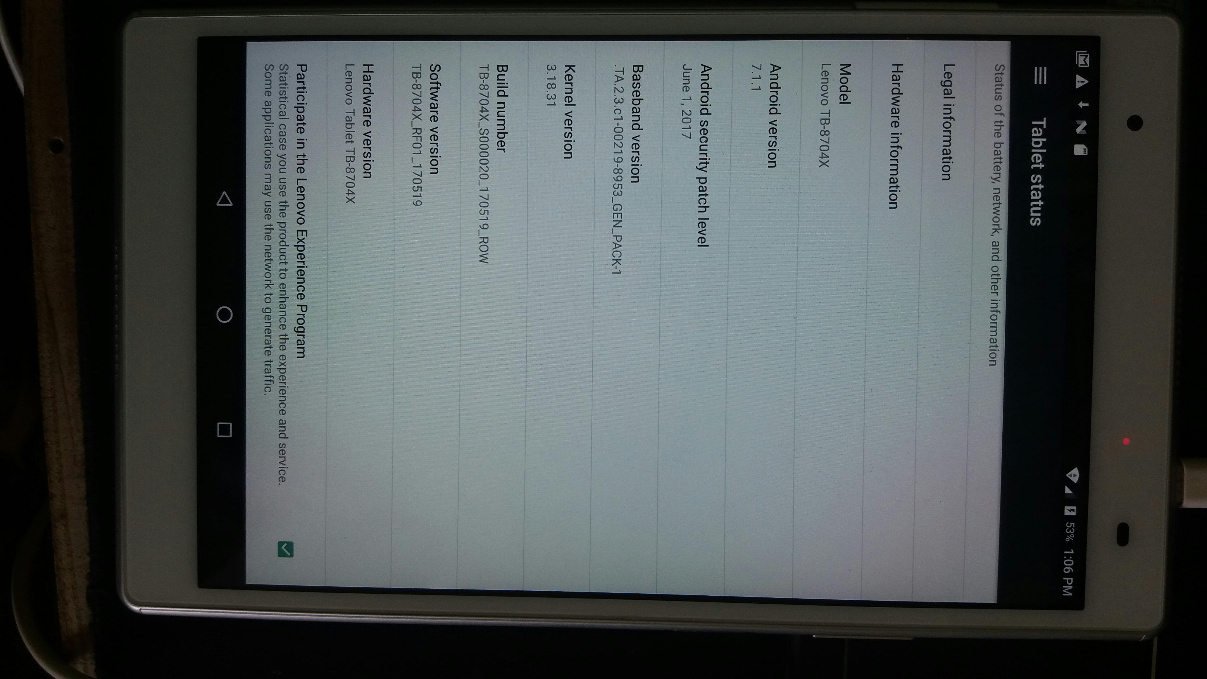

select exact model: tb-8704x
CLICK port to scan
click remove account lock
then click Start and hold vol- and connect edl cable to phone and w8 until recognize and process removal of account..
Done

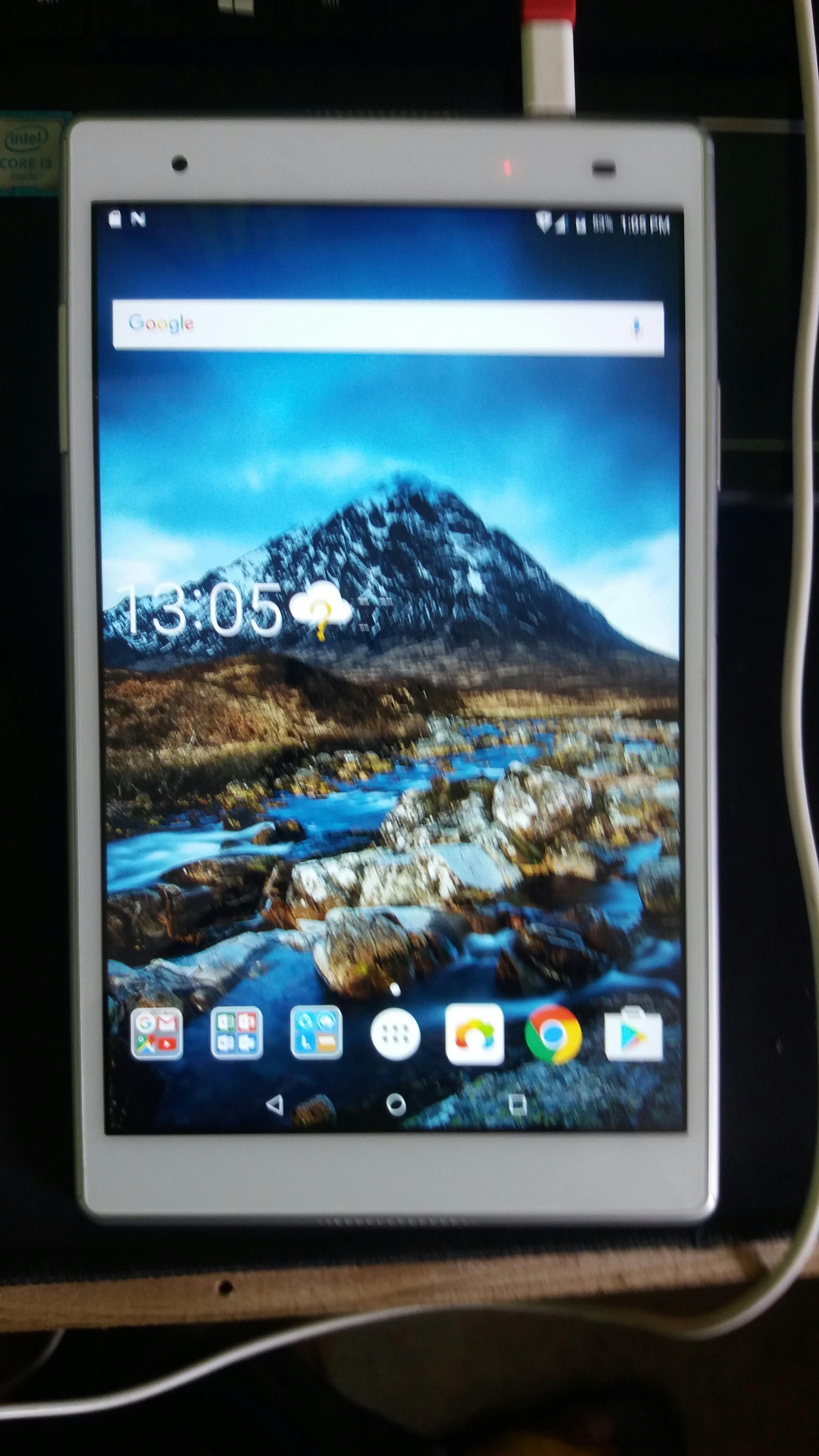

Done na po.. God Bless and More power ANTGSM
