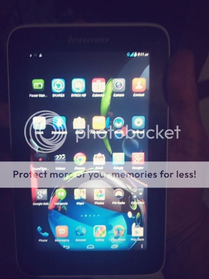

Dahil sa matindi virus sobrang dami error.. unable to root kc malala na.. auto Restart na ang unit..

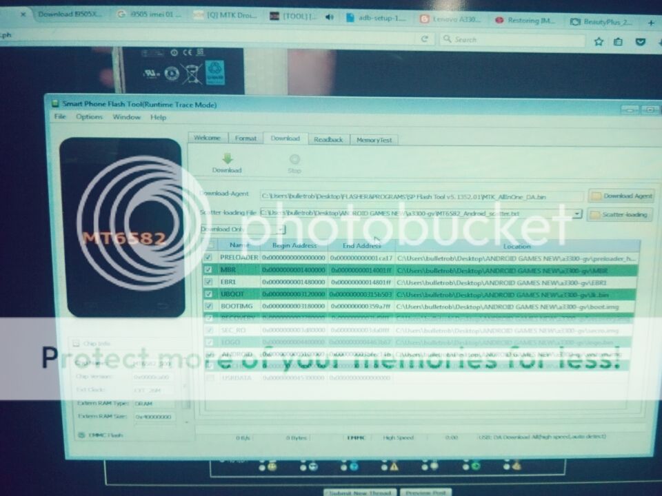

2 parts ang fw na yan download parehas.. naka 7zip ang file.. extract gmit winzip..
fw+driver+flasher
pero ginamit ko pang flash V5.1352.01
open sp flash tool set to format+download
after format pag naka encounter ng error.. set to download mode naman..
hugod usb salpak..
PAG NA FLASH NYO NA.. REBOOT.. THEN STUCK UP SA LOGO LANG YAN..

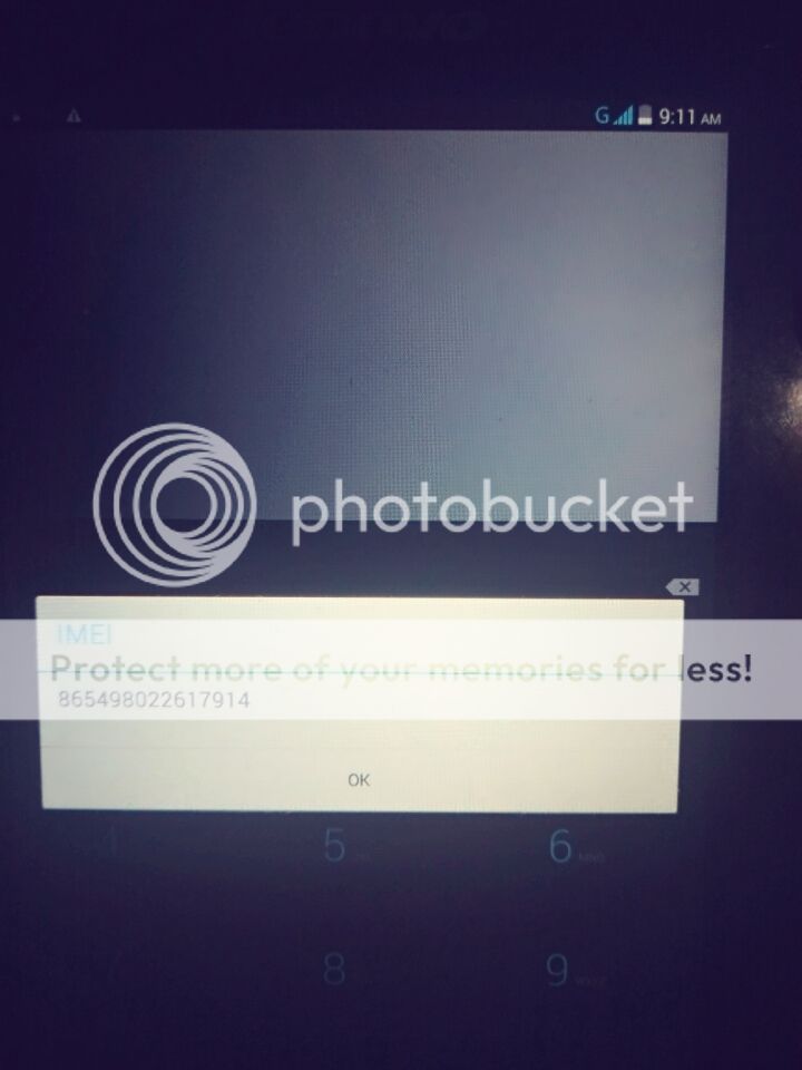

PROBLEM IMEI INVALID YAN..
PROBLEMA KO BURADO NA ORIG IMEI NETO UNIT.. SO SOLUTION HANAP AKO IBA IMEI..
NAKAKITA KO IMEI SA MODEL NA.. A3300-HV.. COPY LANG
DAHIL WALA AKO VOLCANO BOX.. hanap ng ibang solusyon..
try ko eto - code dial - *#*#3646633#*#*
LALABAS SETTINGS ENGINEERMODE.. set to
GPRS
Write IMEI
THEN TYPE NYO IMEI NG UNIT.. THEN HIT ATTACHED..
OFF UNIT.. INSERT ANG SIM.. POWER ON.. BOOOOOOMMM.. MAGSAYA NA.. INUMAN NA...:D :D :D :)))
