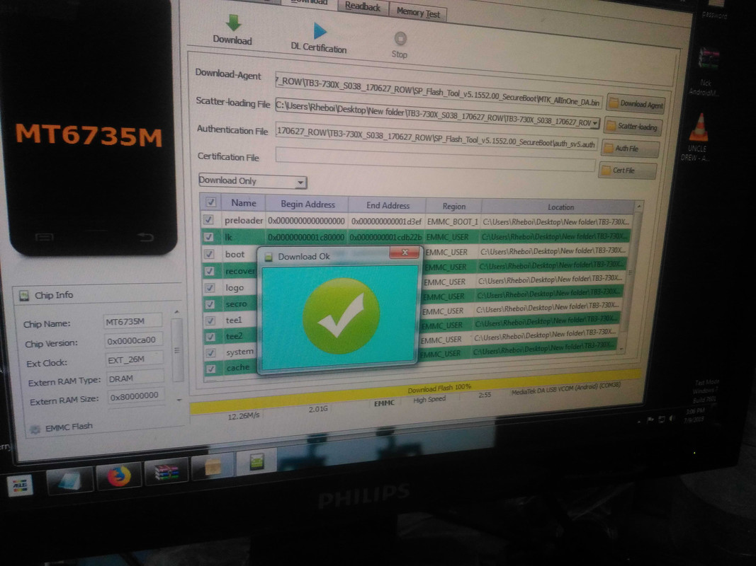

INSTRUCTION !!
RUN SP Flash Tool
After Opening Tool, Press CTRL+ALT+S keys Together To Activate Authentication Mode
First Load MTK_allinOne_DA.bin(if this don't work,try another agent in Download Agent Field
Second Load MTK6735_Android_Scatter.txt from SW/Target_bin directory
Third Load Authentication auth_sv5.auth file in Authentication field
Now Change Download Only option To Download Only
Finally Connect Your Tab Through USB cable with Your PC, keep your Tab PowerOff
Now Click On Green Download Button:D:D:D

labas natin ang image:D
