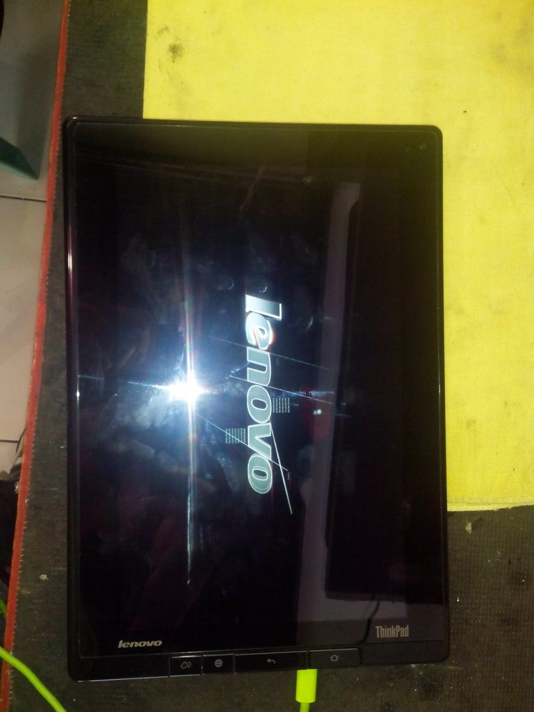

Lenovo ThinkPad Tablet 18382DG
hang on LOGO..
http://i613.photobucket.com/albums/...yeahbah1/IMG_20161015_1333421_zpsl9htveky.jpg

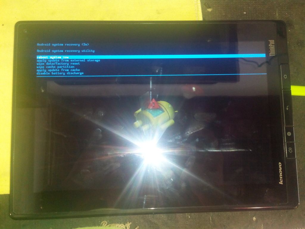

press power button 3-4secs after vibrate press volume up for 3times .. tapos lalabas po ung logo na merong nakalagay na recovery mode sa upper right ng tablet ..
then enter na po kayo ng recovey volume buttons po ang gamiting cursor at power buttons naman po ang pang select .. nasa ilalim po ang prof ..
http://i613.photobucket.com/albums/...yeahbah1/IMG_20161015_1331241_zps99adahuk.jpg
http://i613.photobucket.com/albums/...yeahbah1/IMG_20161015_1331511_zpsd3osf6sl.jpg

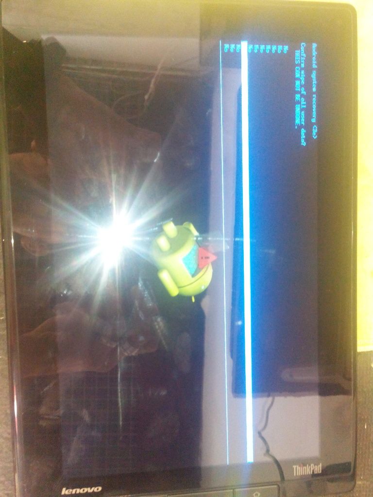

eto naman po makikita pagtapos na ma reboot ang system hintayin lang po at medyo matagal ng konti..
http://s613.photobucket.com/user/dj...61015_1334331_zpste9jjby1.jpg.html?sort=3&o=2

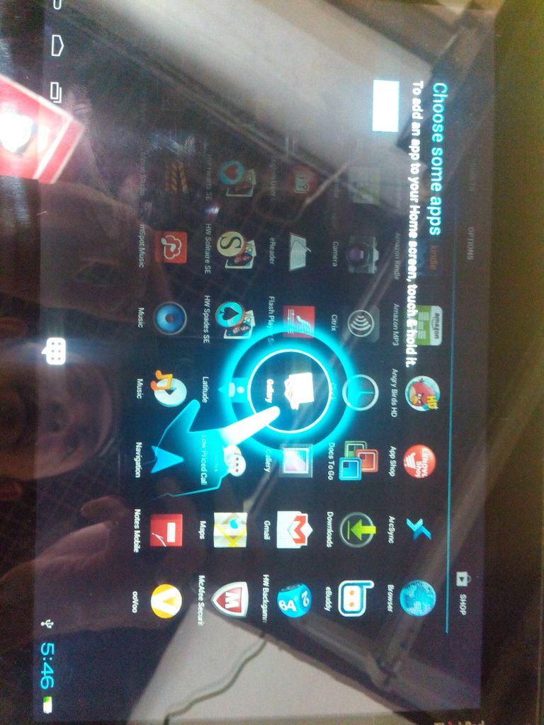

after installing po ng SW nya .. done na po at smile
http://i613.photobucket.com/albums/...yeahbah1/IMG_20161015_1337131_zpsvi0udpbc.jpg
