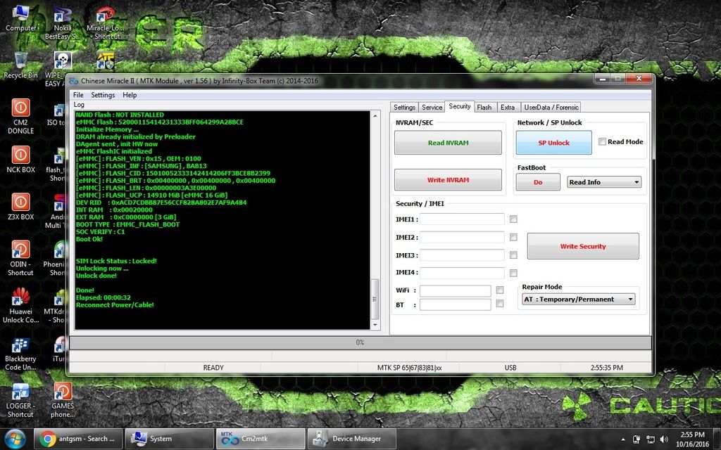

Lenovo Vibe K4 Note globe locked done sa cm2
full_link
Jan 21, 2015
37
5
roxas city capiz
Lenovo Vibe K4 Note globe lock done sa cm2
Procedure:
OPEN CM2 MTK
SET ANG TAMANG CHIPS SA SETTINGS
THEN GO TO FLASH READ FLASH MUNA OR BACK UP PARA SAFE PAG NAGKA PROBLEMA
GO TO SECURITY
HIT SP UNLOCK
WAIT LANG MATAPOS
WARNING BACKUP MO MUNA PARA SAFE
