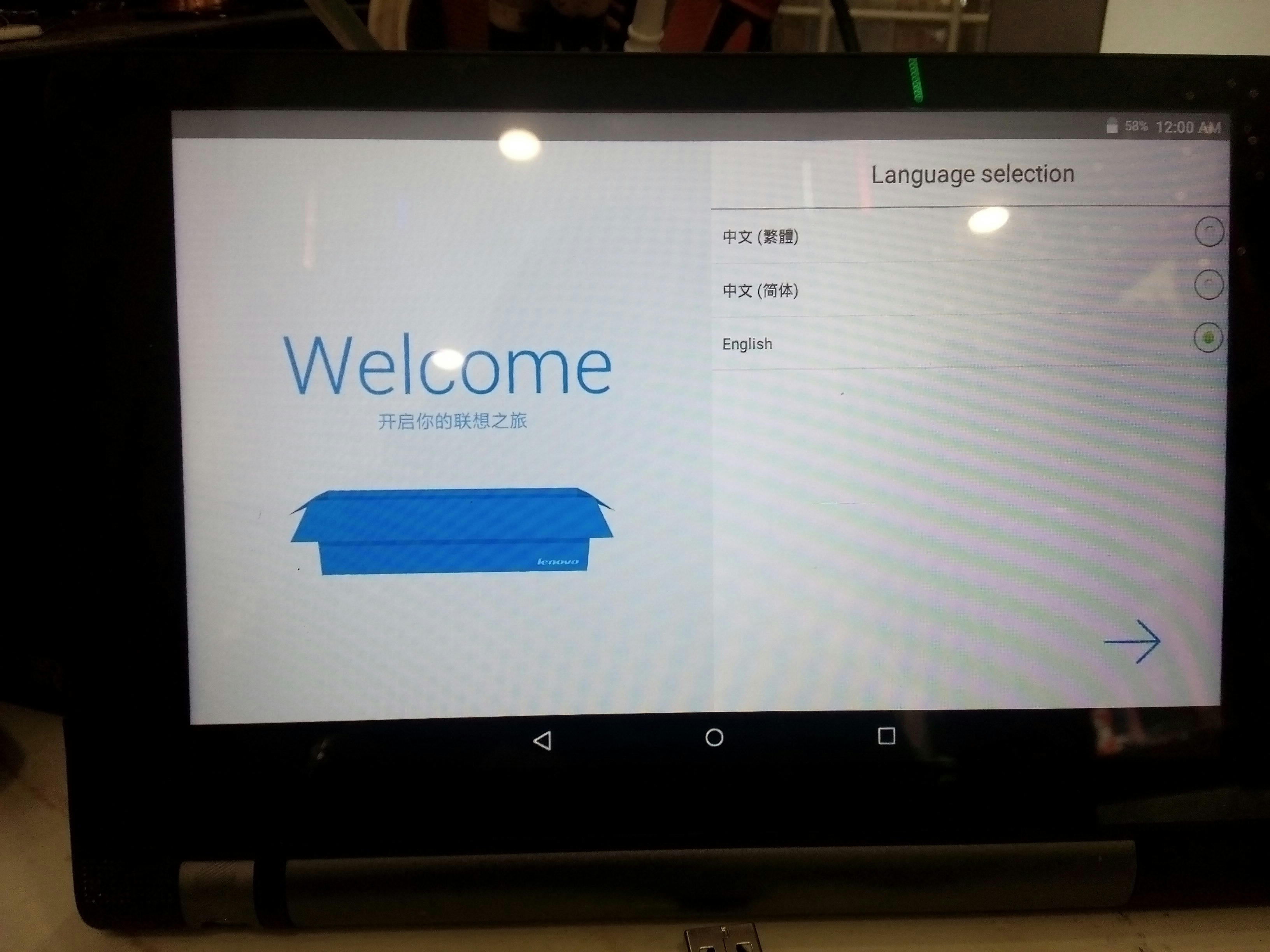

Share ko lng po mga bos lenovo yt3-850f unfortunately error problem..
1st option ko is Hard Reset but sad to say same problem padin then last search d2 sa forum kaso wla ako makita kya try kay google at d nman ako nabigo..
Firmware Link: http://www.mediafire.com/file/afa04zkza2aaecr/Lenovo_YT3_850F_OTA.zip
Procedure:
DL mo muna yung firmware after DL
extract mo then copy ung update.zip sa memory card
rename mo ung update.zip gawin UPDATE.APP then procede to flashing,salpak si memory card sa tablet then boot in recovery mode by pressing power button and volume up button,kpag lumabas si recovery click ang update via sd card then hintay mo lng matapos...
SS:

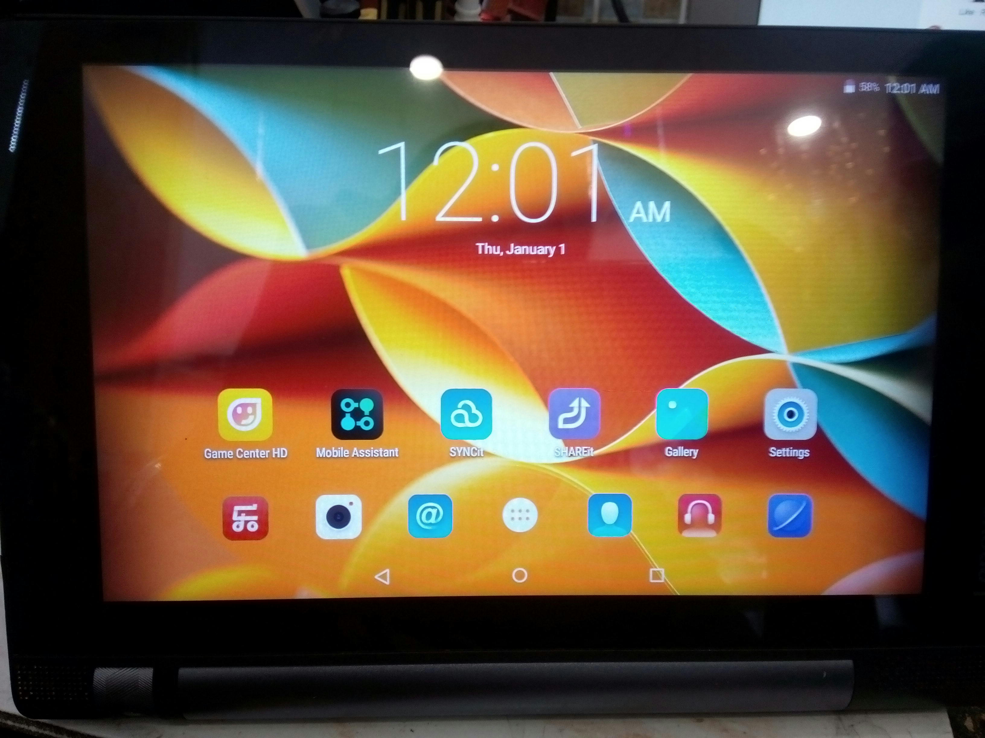

DOne...
