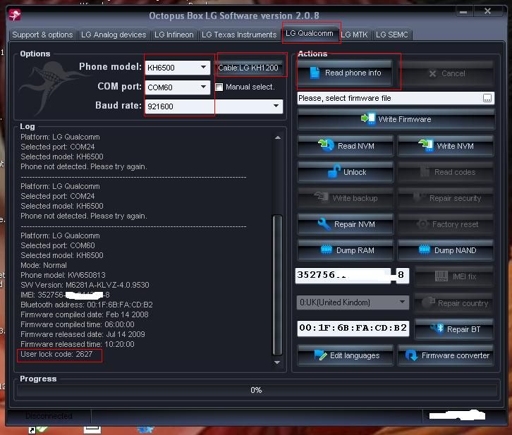

unit : lg cyon kh6500
problem : security code
tools
octopus box
kh1200 cable
pocedure
1 connect octopus box
2 open octopus software
3 select right qualcom tab model kh6500
4 power on unit
5 connect cable install driver if needed
6 thick read info
that's all!
screen shot!
for reference only
