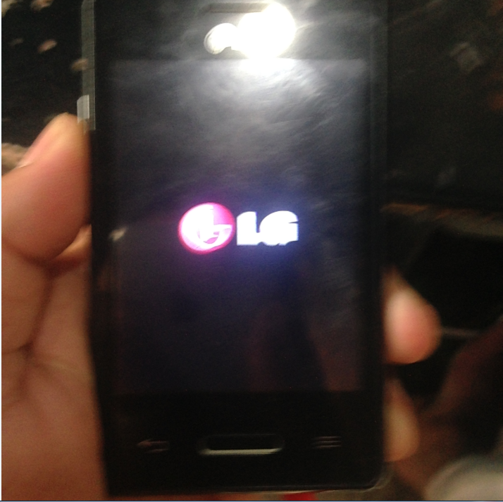

LG E425 LOGO LANG SYA PWD MO SYA EFLASH NG HINDI MABOBORA ANG MGA FILE NE
TOMER .. KAYA ITO PAKI SUNDAN NALANG PO .

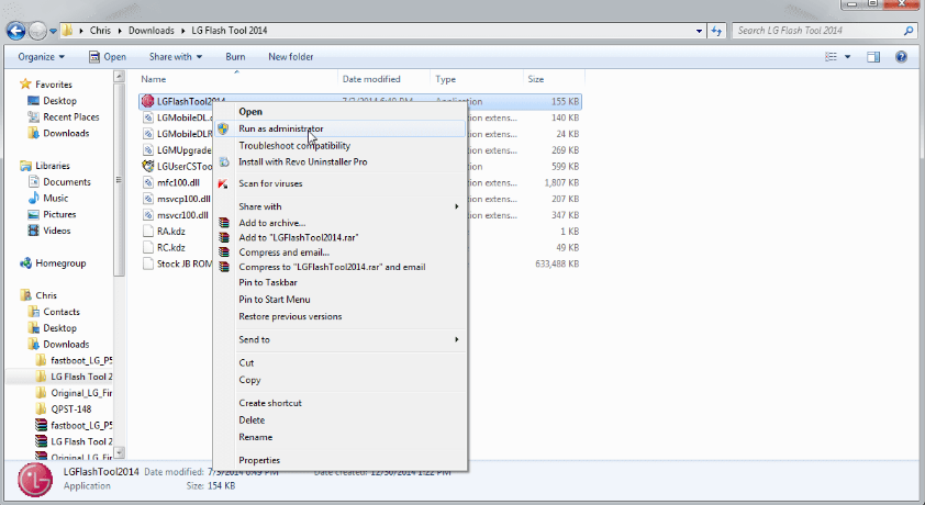

1: DOWNLOAD THIS FLASH TOOL .. https://androidfilehost.com/?fid=95864024717072254
2:INSTALL MO AT SUNDAN MO ANA NSA PICTURES .

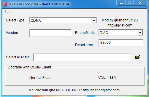

This will appear. Leave all the way it is and press the little folder in the right.

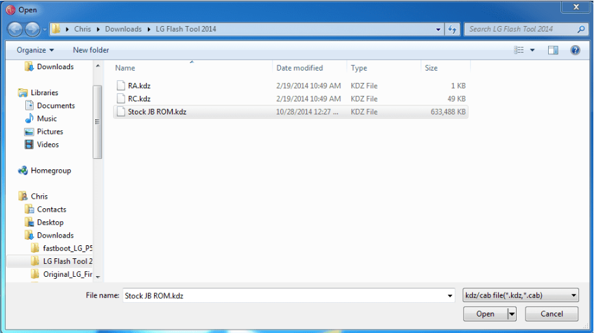

Select the KDZ you placed at point 4.B. and press Open (DO NOT SELECT RA or RC KDZ
After you pressed Open you are back to the main screen you saw at point 4.C. Good.
Press Normal Flash (the left option) if you want to flash new KDZ preserving data (no data will be deleted). I do not suggest this because you might get a bootloop and you need to hard-reset (will wipe data). Always have all data backed-up.
Press CSE Flash (recommended) if you want to flash new KDZ with full wipe of data.

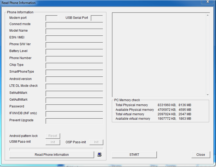

After selecting what you want you will get this screen.
Press START.
After you pressed START you will get this. DO NOT CHANGE ANYTHING, press OK.
Another dialog will pop and will flash your phone. First it will check USB connection but you already have USB connected when you got in Emergency so you should be fine. I assume you checked drivers at the Driver step so I assume there will be no problems.

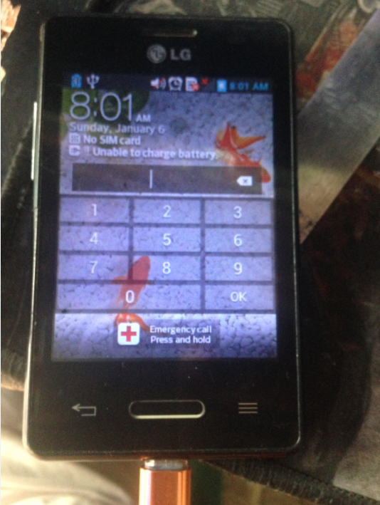

AFTER FLASH W/O ERASE DATA
OPS MAY PASSWORD C TOMER DI NYA ALAM NAKALIMUTAN NA DAW ~X(
ALAM NA KUNG TUNAY KANG CHIKSNICIAN HEHE
