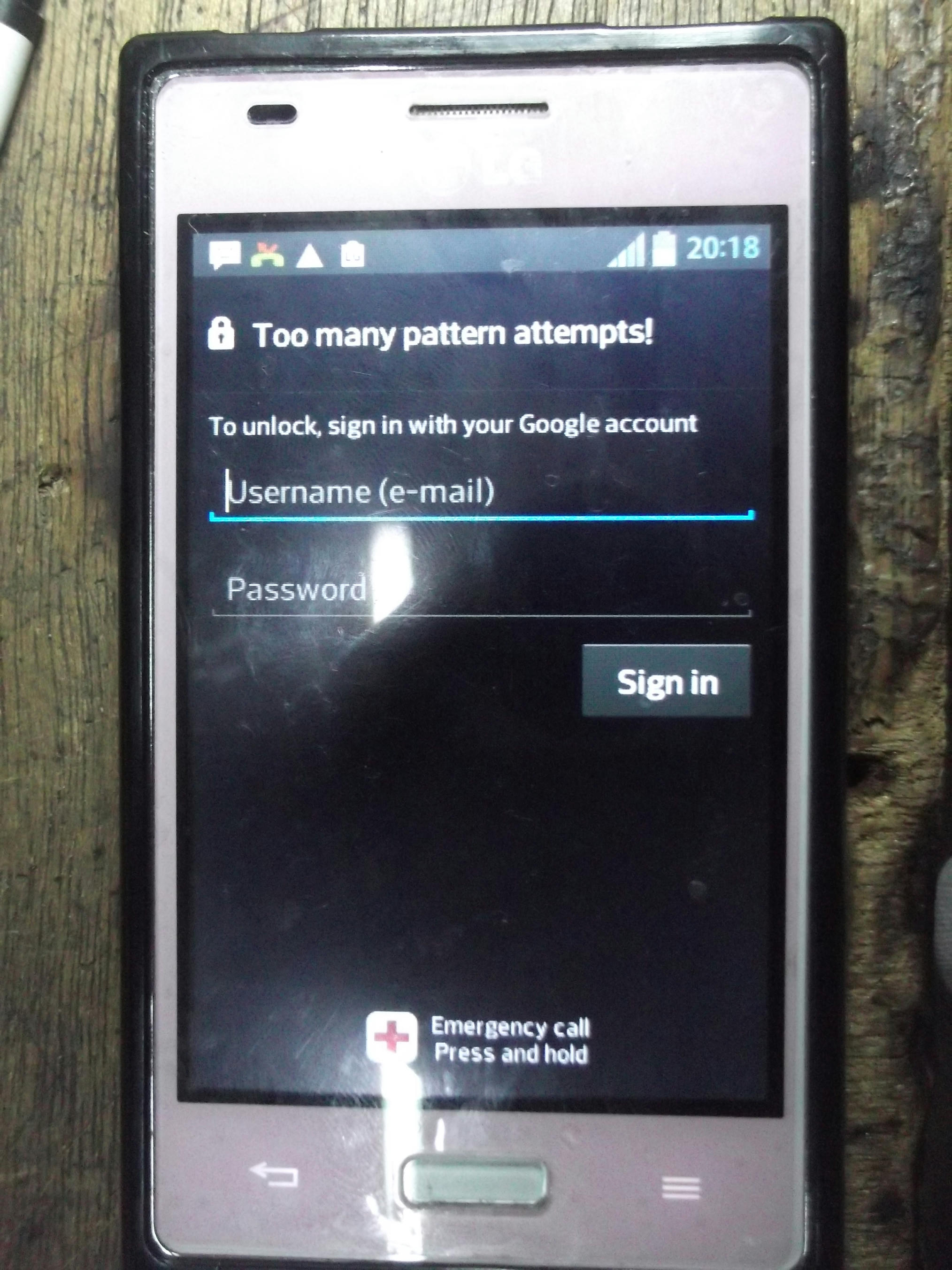

Unit: LG E612
Problem: Too Many Pattern Attempt
Solution #1: Hard Reset by pressing Volume down and Power button
using left hand...tapping home button within 2 seconds..No luck!
Sinubukan na rin po ibang hard reset gamit ang kamay..Still no luck
Also tried SRS root and other android tool but still no luck...Not Debugged
Last Option: Octopus Box

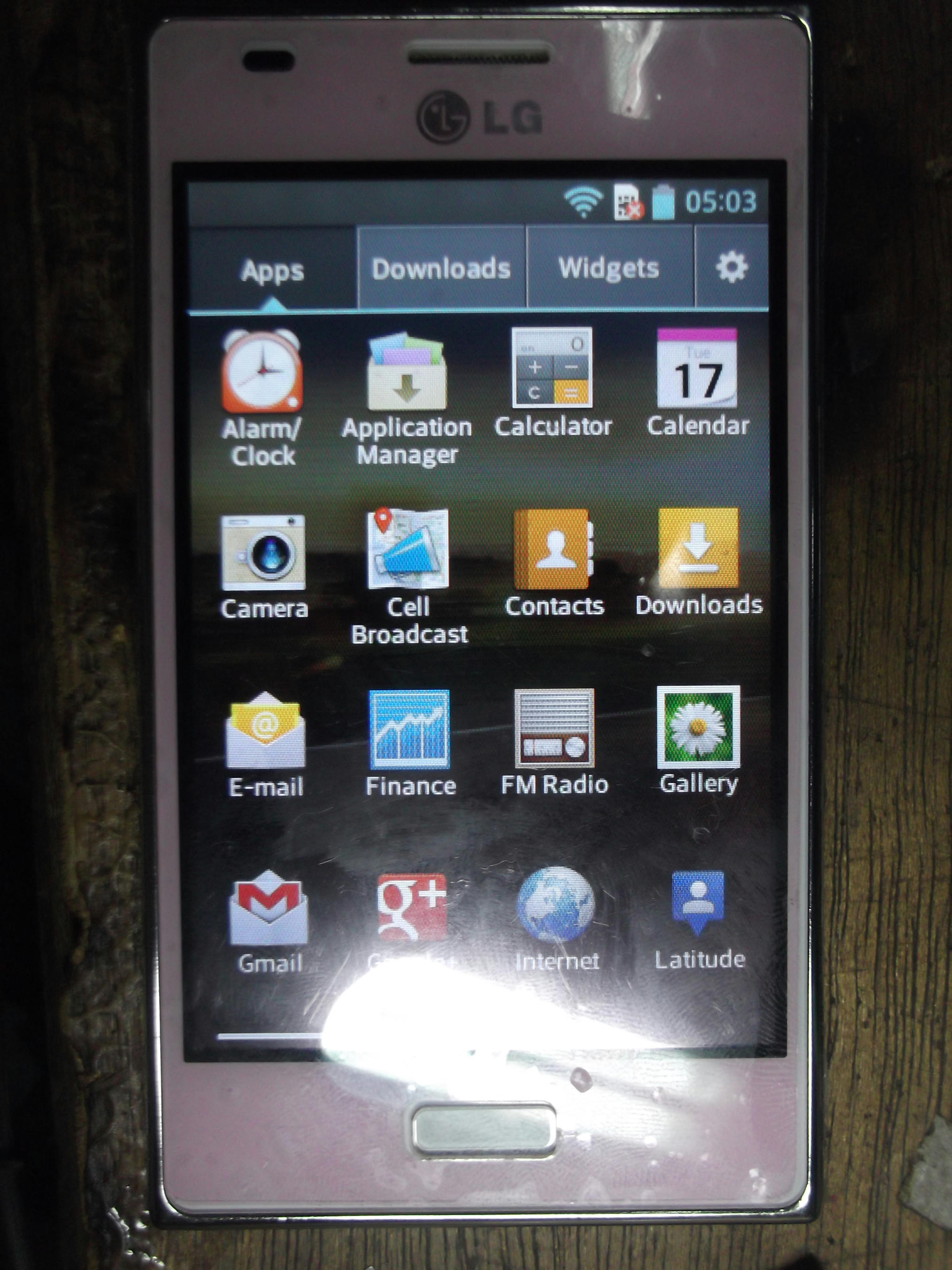

I tried to reset by clicking Reset Screen Lock....Successful pero
Screen Lock lang ang tinanggal...meaning..hind pa supported para
sa Gmail Reset ang Octopus...Tsk Tsk...No luck pa rin..

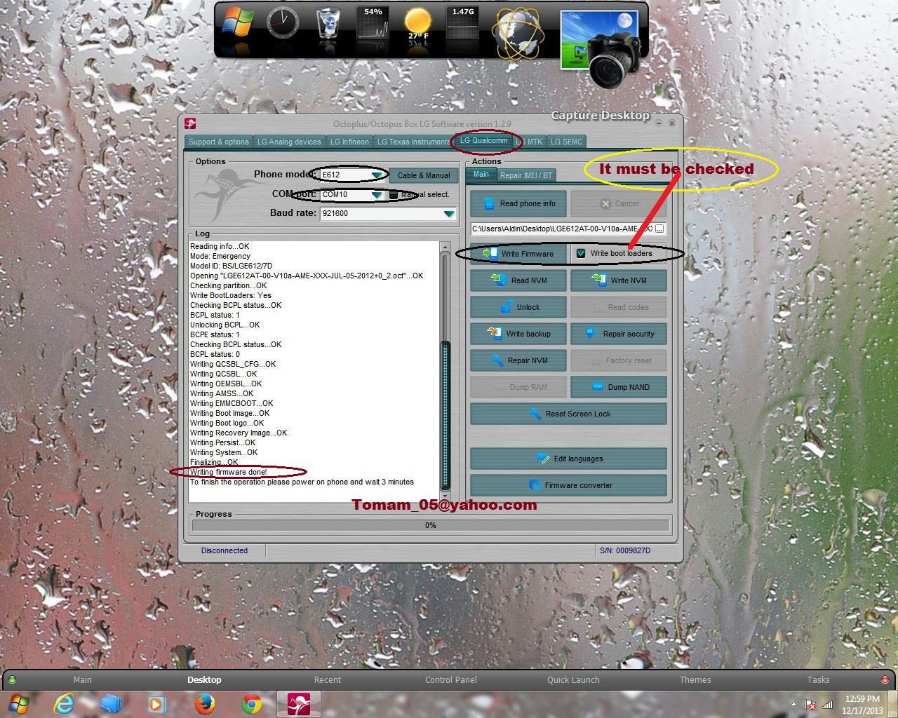

Final Option: Flash ko na lang gamit din ang Octopus Box
Flash File: LGE612AT-00-V10a-AME-XXX-JUL-05-2012+0_2
Pictures:

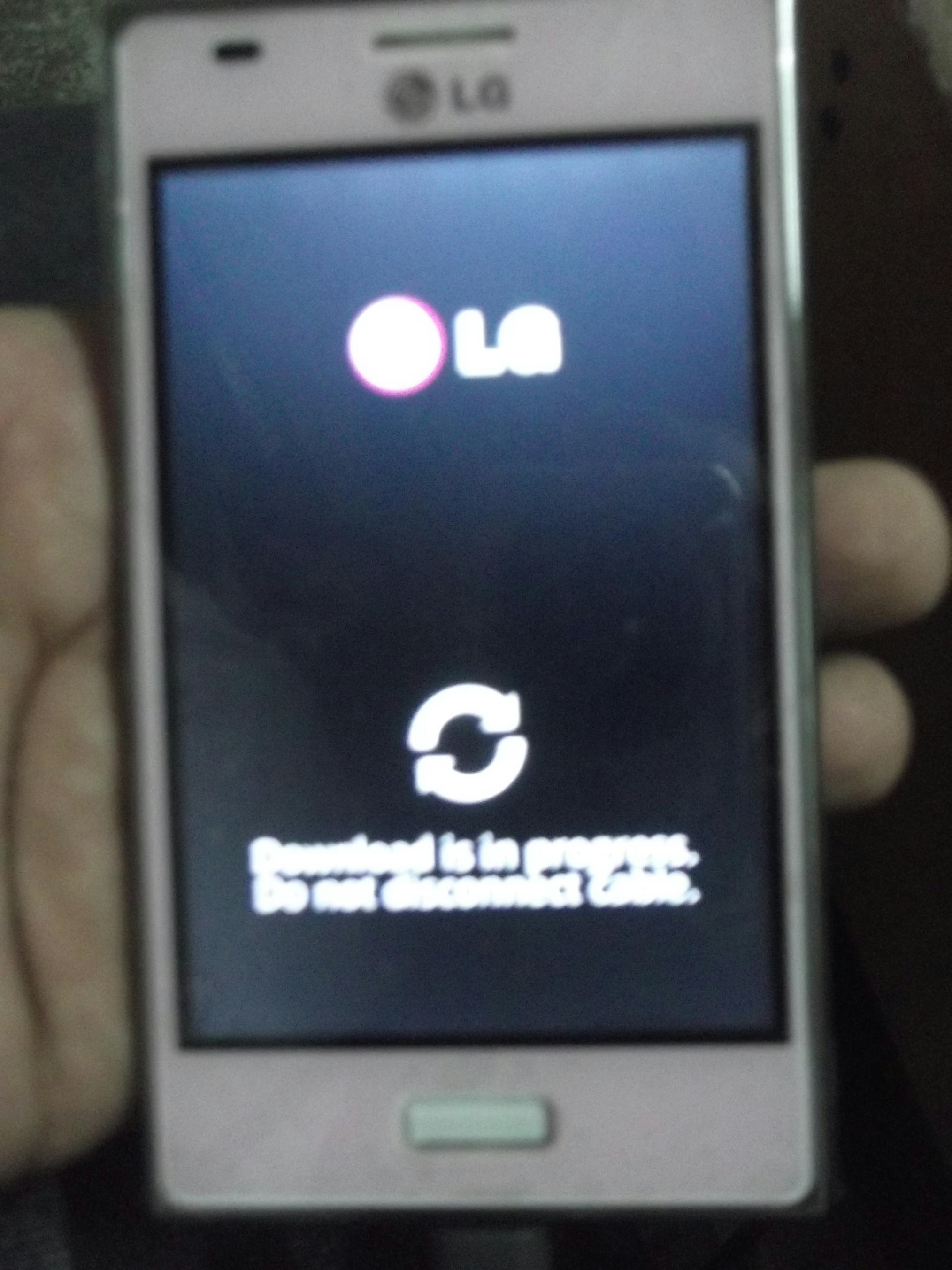

Press Volume Down and UP then connect usb cable For Emergency Mode
DONE na Po......pinahirapan ako nito....ayyyyyyyyyyy...
