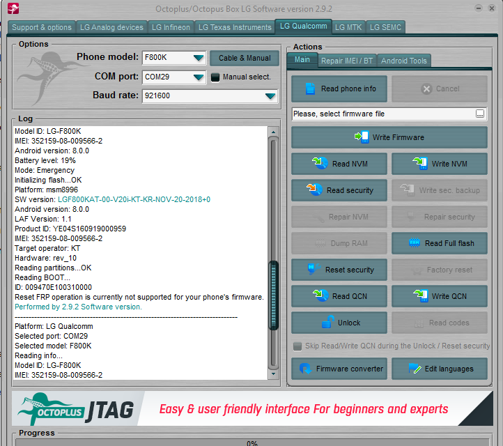

ito ang current version nya
Latest Security F800K20I_00_1120.kdz
Kaya salang kay pusit kaso updated na kaya ito result not supported

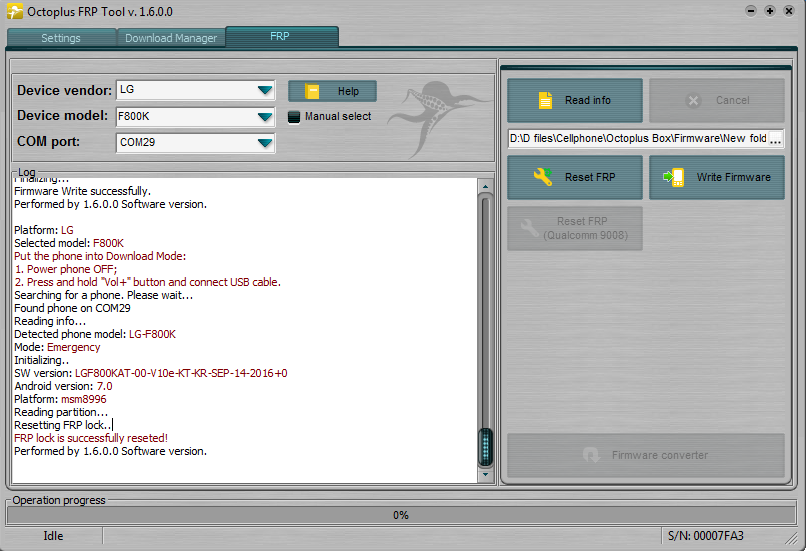

Ito naman decide to Downgrade to 7.0 hindi naman na bigo
Success at Buhay pero may google parin
pwede nang tirahin sa octo LG or FRP octo Done
Done
Ito Logs
Note: pwede i flash sa iba basta supported kdz file
Done
Ito Logs

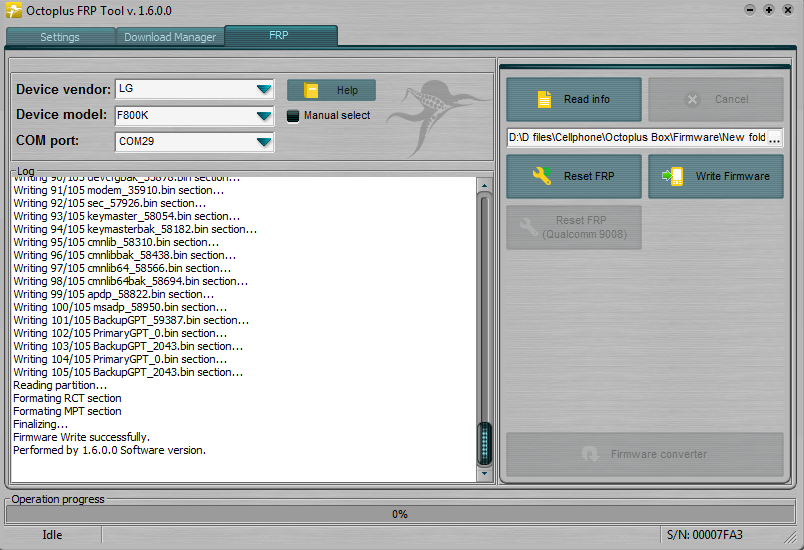

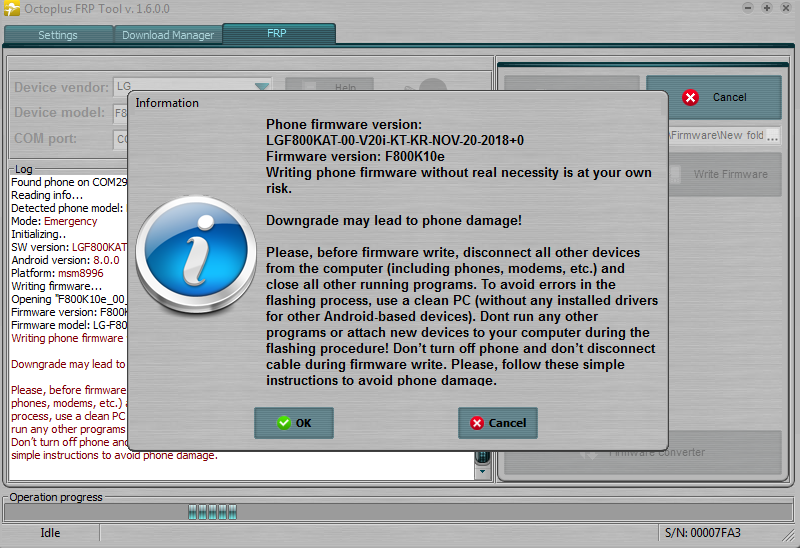

Writing firmware...
Opening "F800K10e_00_0914.kdz"...
Firmware version: F800K10e
Firmware model: LG-F800K
Writing phone firmware without real necessity is at your own risk.
Downgrade may lead to phone damage!
Please, before firmware write, disconnect all other devices from the computer (including phones, modems, etc.) and close all other running programs. To avoid errors in the flashing process, use a clean PC (without any installed drivers for other Android-based devices). Dont run any other programs or attach new devices to your computer during the flashing procedure! Don’t turn off phone and don’t disconnect cable during firmware write. Please, follow these simple instructions to avoid phone damage.
Prepairing firmware...
Setting options...
Reading partition...
Formating USERDATA section
Formating ENCRYPT section
Writing signature...
Writing 1/105 PrimaryGPT_0.bin section...
Writing 2/105 laf_6.bin section...
Writing 3/105 factory_32774.bin section...
Writing 5/105 persist_50310.bin section...
Writing 6/105 lafbak_58502.bin section...
Writing 7/105 system_70790.bin section...
Writing 8/105 system_103911.bin section...
Writing 9/105 system_104414.bin section...
Writing 10/105 system_136829.bin section...
Writing 11/105 system_169447.bin section...
Writing 12/105 system_169950.bin section...
Writing 13/105 system_202365.bin section...
Writing 14/105 system_234983.bin section...
Writing 15/105 system_235486.bin section...
Writing 16/105 system_267901.bin section...
Writing 17/105 system_300519.bin section...
Writing 18/105 system_301022.bin section...
Writing 19/105 system_333437.bin section...
Writing 20/105 system_366055.bin section...
Writing 21/105 system_366558.bin section...
Writing 22/105 system_398973.bin section...
Writing 23/105 system_431741.bin section...
Writing 24/105 system_464509.bin section...
Writing 25/105 system_496774.bin section...
Writing 26/105 system_497277.bin section...
Writing 27/105 system_530045.bin section...
Writing 28/105 system_562813.bin section...
Writing 29/105 system_595581.bin section...
Writing 30/105 system_627846.bin section...
Writing 31/105 system_628349.bin section...
Writing 32/105 system_661117.bin section...
Writing 33/105 system_693382.bin section...
Writing 34/105 system_693885.bin section...
Writing 35/105 system_726653.bin section...
Writing 36/105 system_759421.bin section...
Writing 37/105 system_792189.bin section...
Writing 38/105 system_824957.bin section...
Writing 39/105 system_857725.bin section...
Writing 40/105 system_890343.bin section...
Writing 41/105 system_890846.bin section...
Writing 42/105 system_923261.bin section...
Writing 43/105 system_955879.bin section...
Writing 44/105 system_956382.bin section...
Writing 45/105 system_988797.bin section...
Writing 46/105 system_1021565.bin section...
Writing 47/105 system_1054333.bin section...
Writing 48/105 system_1087101.bin section...
Writing 49/105 system_1119869.bin section...
Writing 50/105 system_1152637.bin section...
Writing 51/105 system_1185405.bin section...
Writing 52/105 system_1218173.bin section...
Writing 53/105 system_1250941.bin section...
Writing 54/105 system_1283709.bin section...
Writing 55/105 system_1316477.bin section...
Writing 56/105 system_1349245.bin section...
Writing 57/105 system_1382013.bin section...
Writing 58/105 system_1414278.bin section...
Writing 59/105 system_1414781.bin section...
Writing 60/105 system_1447046.bin section...
Writing 61/105 system_1480007.bin section...
Writing 62/105 BackupGPT_15546363.bin section...
Writing 63/105 PrimaryGPT_0.bin section...
Writing 64/105 xbl_6.bin section...
Writing 65/105 xblbak_774.bin section...
Writing 66/105 BackupGPT_4091.bin section...
Writing 67/105 PrimaryGPT_0.bin section...
Writing 68/105 xbl2_6.bin section...
Writing 69/105 xbl2bak_774.bin section...
Writing 70/105 BackupGPT_2043.bin section...
Writing 71/105 PrimaryGPT_0.bin section...
Writing 72/105 BackupGPT_2043.bin section...
Writing 73/105 PrimaryGPT_0.bin section...
Writing 74/105 boot_6.bin section...
Writing 75/105 recovery_10246.bin section...
Writing 76/105 recoverybak_20614.bin section...
Writing 77/105 tz_30982.bin section...
Writing 78/105 tzbak_31494.bin section...
Writing 79/105 aboot_32006.bin section...
Writing 80/105 abootbak_32518.bin section...
Writing 81/105 raw_resources_33030.bin section...
Writing 82/105 raw_resourcesbak_34054.bin section...
Writing 83/105 rpm_35078.bin section...
Writing 84/105 rpmbak_35206.bin section...
Writing 85/105 hyp_35334.bin section...
Writing 86/105 hypbak_35462.bin section...
Writing 87/105 pmic_35590.bin section...
Writing 88/105 pmicbak_35718.bin section...
Writing 89/105 devcfg_35846.bin section...
Writing 90/105 devcfgbak_35878.bin section...
Writing 91/105 modem_35910.bin section...
Writing 92/105 sec_57926.bin section...
Writing 93/105 keymaster_58054.bin section...
Writing 94/105 keymasterbak_58182.bin section...
Writing 95/105 cmnlib_58310.bin section...
Writing 96/105 cmnlibbak_58438.bin section...
Writing 97/105 cmnlib64_58566.bin section...
Writing 98/105 cmnlib64bak_58694.bin section...
Writing 99/105 apdp_58822.bin section...
Writing 100/105 msadp_58950.bin section...
Writing 101/105 BackupGPT_59387.bin section...
Writing 102/105 PrimaryGPT_0.bin section...
Writing 103/105 BackupGPT_2043.bin section...
Writing 104/105 PrimaryGPT_0.bin section...
Writing 105/105 BackupGPT_2043.bin section...
Formating RCT section
Formating MPT section
Finalizing...
Firmware Write successfully.

Platform: LG
Selected model: F800K
Put the phone into Download Mode:
1. Power phone OFF;
2. Press and hold "Vol+" button and connect USB cable.
Searching for a phone. Please wait...
Found phone on COM29
Reading info...
Detected phone model: LG-F800K
Mode: Emergency
Initializing..
SW version: LGF800KAT-00-V10e-KT-KR-SEP-14-2016+0
Android version: 7.0
Platform: msm8996
Resetting FRP lock..
FRP lock is successfully reseted!
Performed by 1.6.0.0 Software version.
