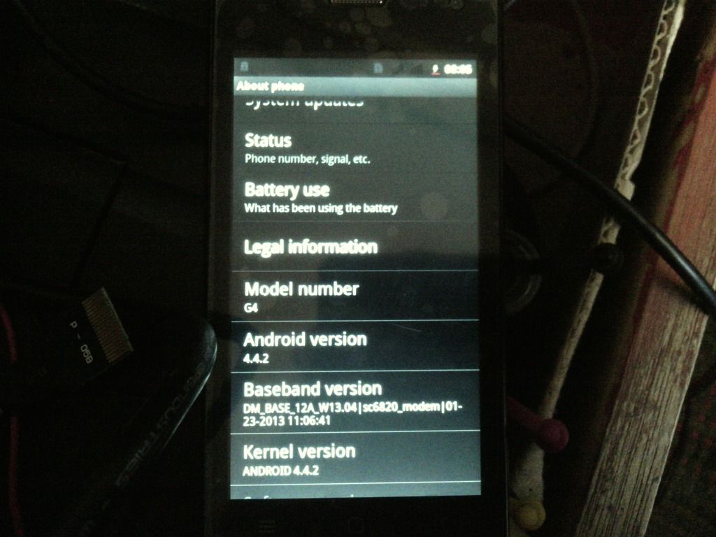

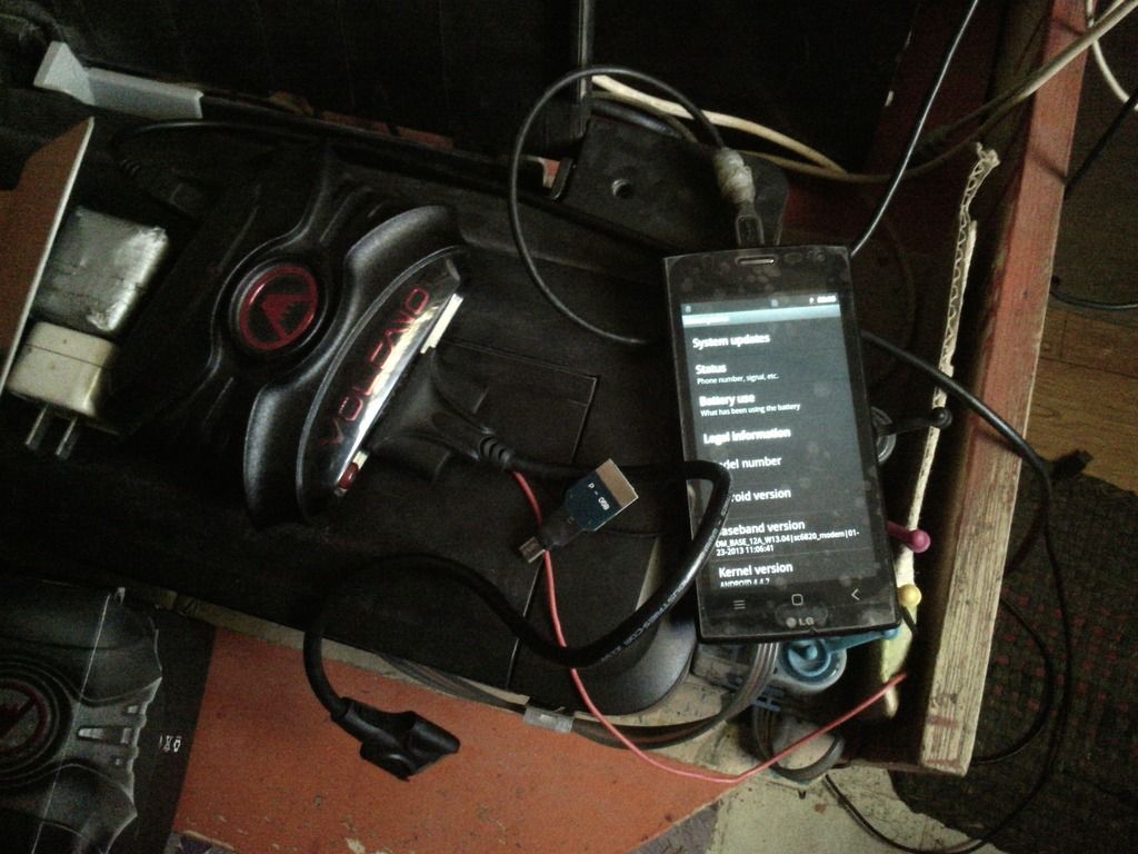

good day sir! Success yung firmware na bngay mo! maraming maraming salamat bale sa miracle software (No box) ko sya flash at format, kumagat naman. bali ginamitan ko rin ng volcano box kz hindi na ma detect sa usb. Pag nakasaksak sa volcano nadedetect ng pc kaya ganun gnawa ko. thnx ulit!

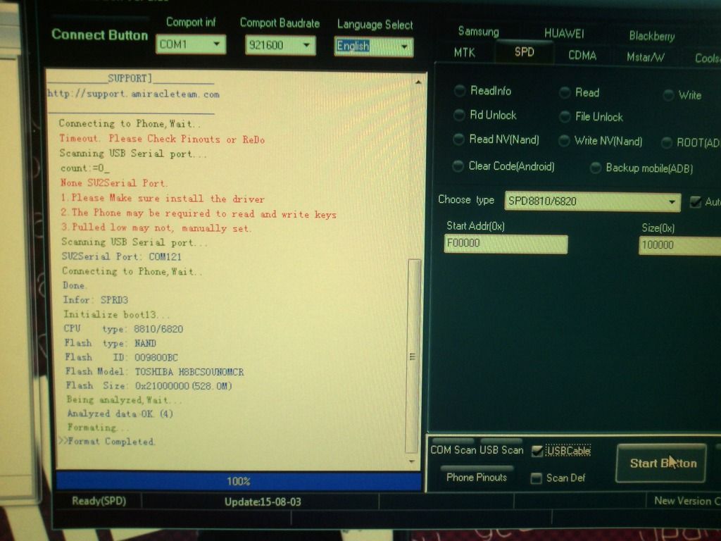

Salamat po sa firmware...tested po after flashing sa miracle crack...after flash po format lang natin....

logs
Scanning USB Serial port...
SU2Serial Port: COM3
Connecting to Phone,Wait..
Done.
Infor: SPRD3
Initialize boot13...
CPU type: 8810/6820
Flash type: NAND
Flash ID: 009800BC
Flash Model: TOSHIBA H8BCS0UN0MCR
Flash Size: 0x21000000(528.0M)
Eraseing Flash...
Erase Completed.(114)
writing,Wait...
>>Write Completed.
