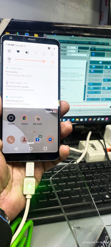

to enable diag
dial ##3424#
then enable diag
on mo rin debuger alam muna yun syempre..

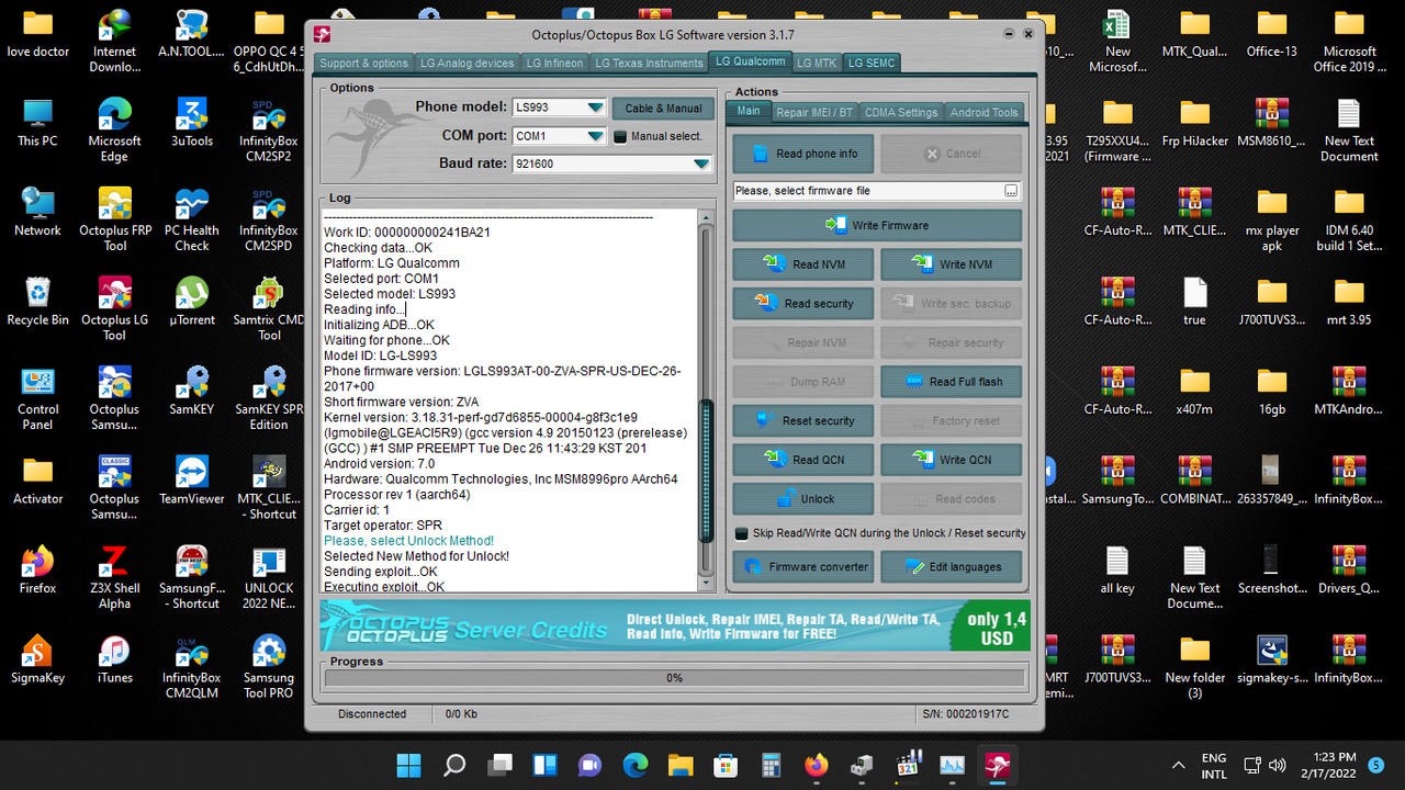

open octoplus or octopus select mo LS993
wag mo select h870 or h873 di mag dedetect yan kahit tubuan ka ng uban ;))
logs;
Welcome to Octoplus/Octopus Box LG Software version 3.1.7
Card S/N : 000201917C
Work ID: 000000000241B9C8
Checking data...OK
Platform: LG Qualcomm
Selected port: COM1
Selected model: LS993
Reading info...
Initializing ADB...OK
Waiting for phone...OK
Model ID: LG-LS993
Phone firmware version: LGLS993AT-00-ZVA-SPR-US-DEC-26-
2017+00
Short firmware version: ZVA
Kernel version: 3.18.31-perf-gd7d6855-00004-g8f3c1e9
(lgmobile@LGEACI5R9) (gcc version 4.9 20150123 (prerelease)
(GCC) ) #1 SMP PREEMPT Tue Dec 26 11:43:29 KST 201
Android version: 7.0
Hardware: Qualcomm Technologies, Inc MSM8996pro AArch64
Processor rev 1 (aarch64)
Carrier id: 1
Target operator: SPR
Please, select Unlock Method!
Sending exploit...OK
Executing exploit...OK
Unlocking...

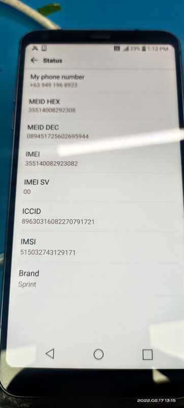

Phone successfully unlocked!
Rebooting phone...
Performed by 3.1.7 Software version.
Work ID: 000000000241BA21
Checking data...OK
Selected port: COM1
Reading info...
Model ID: LG-LS993
2017+00
Carrier id: 1
Selected New Method for Unlock!
Unlocking...
Rebooting phone...
finish product
