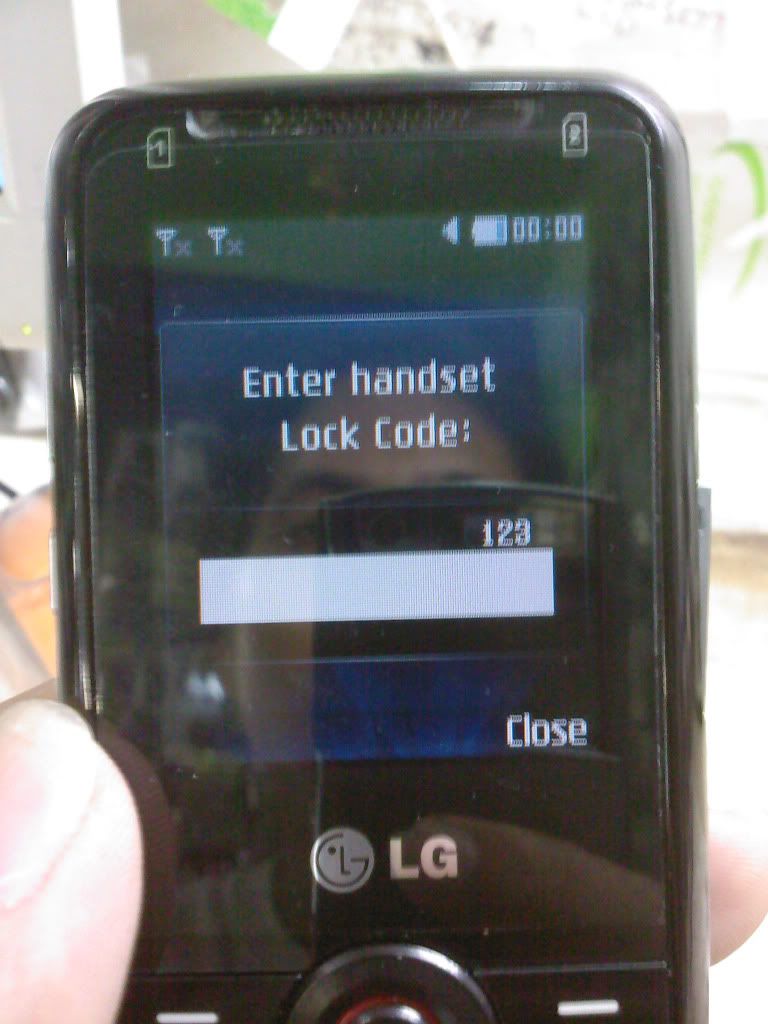

LG GX200 lock code, done in Infinity
LG GX200 lock code, done in Infinity......
tools:
*infinity box
*modified RJ45 cable
*MModule v3.54 infinity software(DL at support site)
procedures:
*create modify RJ45 cable(see below for pinout)
*connect infinity box
*open infinity software
*select model
*select comport
*connect phone and RJ45 cable to infinity box
*click service tab
*click lock code button
*wait til finish......

COM6 [VCP0] selected
module v3.54
Action: read unlock codes
unlock method: read codes
Model: LG-GX200
Checking data, wait...
Phone should be Switched OFF !
Press and HOLD Power button now !
19200 autodetect
Initializing [6235:8A04:8A01]...
CPU: MT6235
chip: 0000:0000:0003
status: FF
rom: 4D573031
Connecting at 19200, wait...
Release Power button now !
Phone detected, wait...
Hardware: MT6235,E04
Date: 2000.00.00
Version: 1.0
Version: GX200-00-V10d-ESA-XX-FEB-24-2010
Version: ARIMA6235_GEMINI_09A_HW
82 byte(s) read
imei: 35880803216488
connection Ok
189 byte(s) read
38 byte(s) read
Phone lock: Off
Phone code: 1224
Finished, time used: 7 min 13 sec
Remove/Install battery now !
Phone lock code done...........
