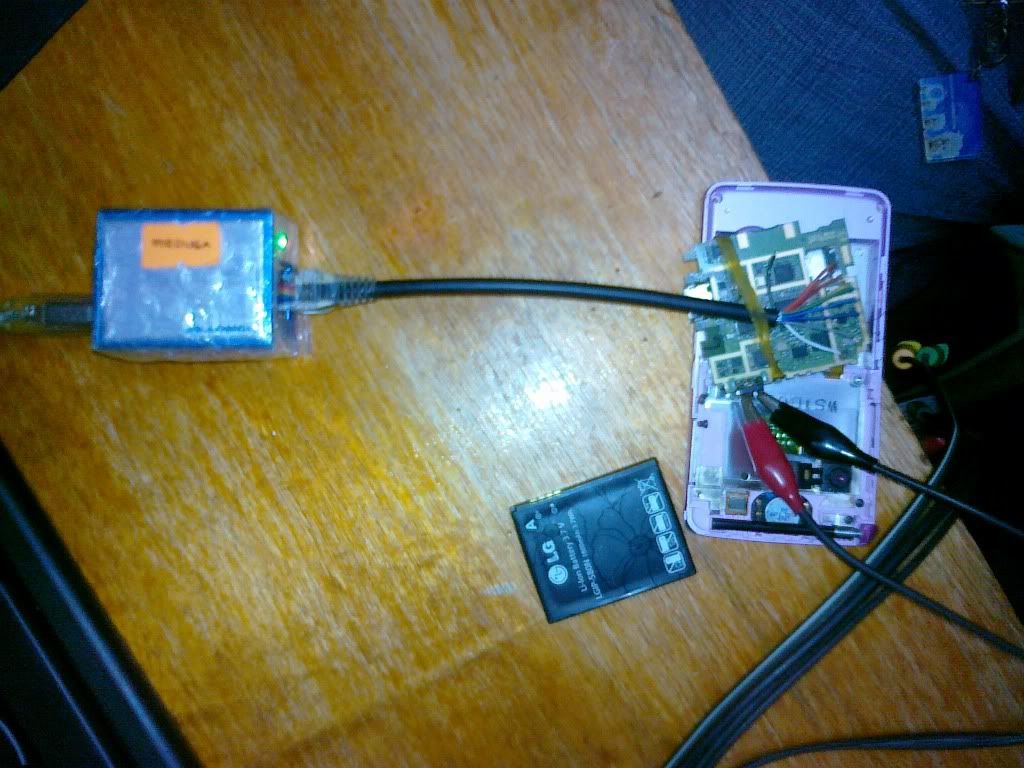

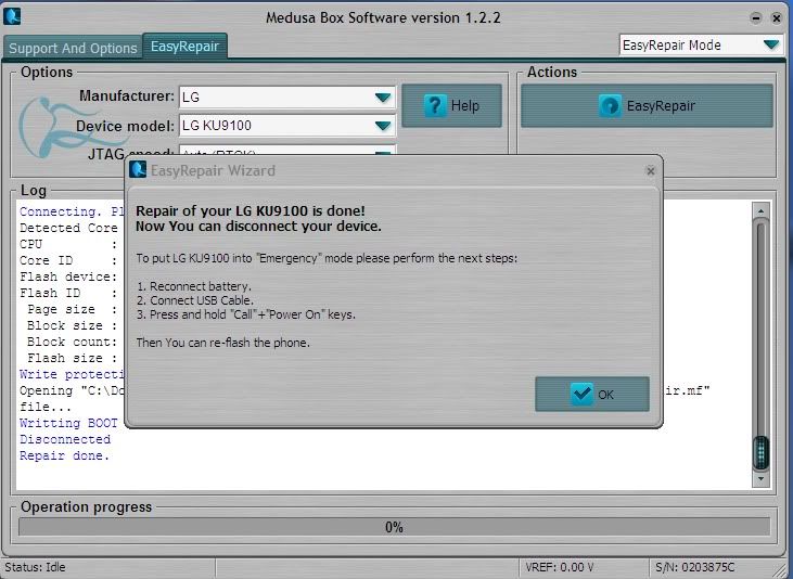

LG CYON KU-9100​
Tools:
- 10pins rj45 Jtag wire
- medusa box
- regulated power supply
- octopus box
Procedure:

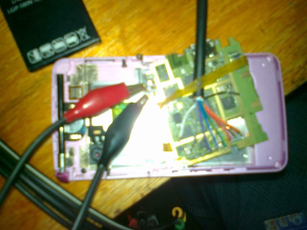

- connect the wires in their specific location
- connect supply
- tick easy repair

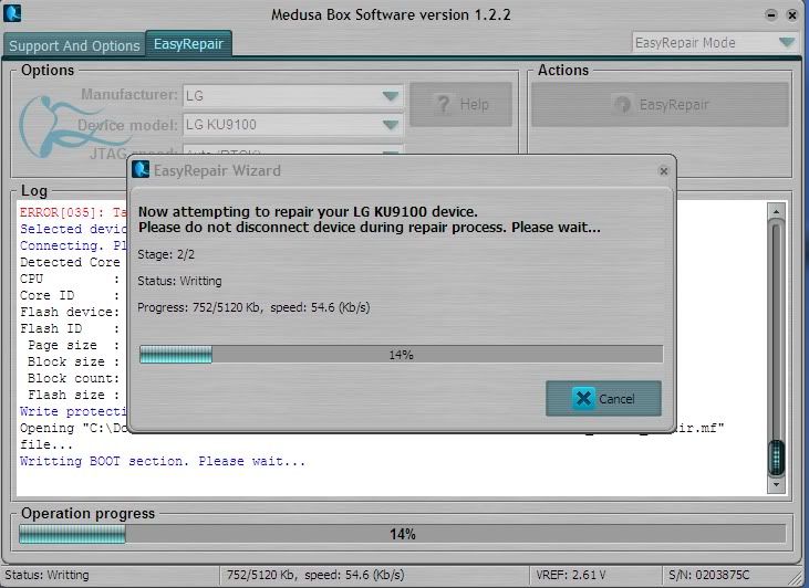

- select correct boot files
- press power on wait till vref supply detect
(short ds_hold to vref to detect)
- wait till writing boot finished
- fullflash to octopus box
- Done
