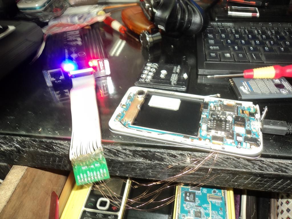

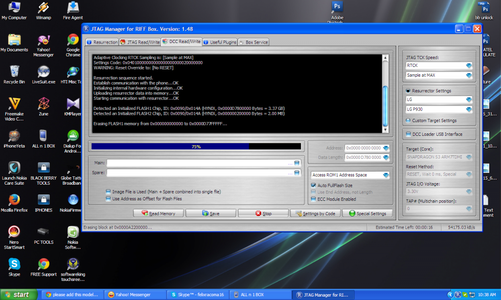

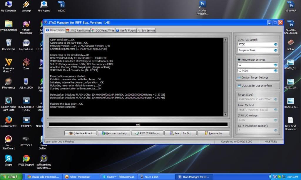

Lg-lu6200 dead boot done
tolls -riff jtag
deadboot problem

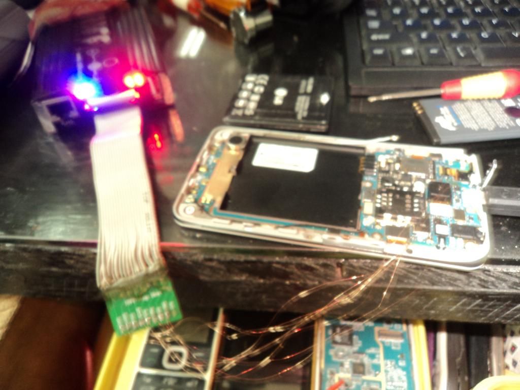

dismantle unit then solder pinout
run software riff jtag
select model p930 alternate model not lu6200
Disable ID Code From Box Service/Advanced Setting
Take 256 or 512mb from dead Phone With DCC Page
Resurrect With P930.dll
go to resurrection click
waiting for a second done

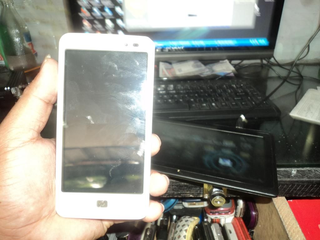

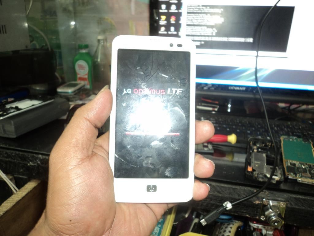

after that if the unit hang
hang logo stock

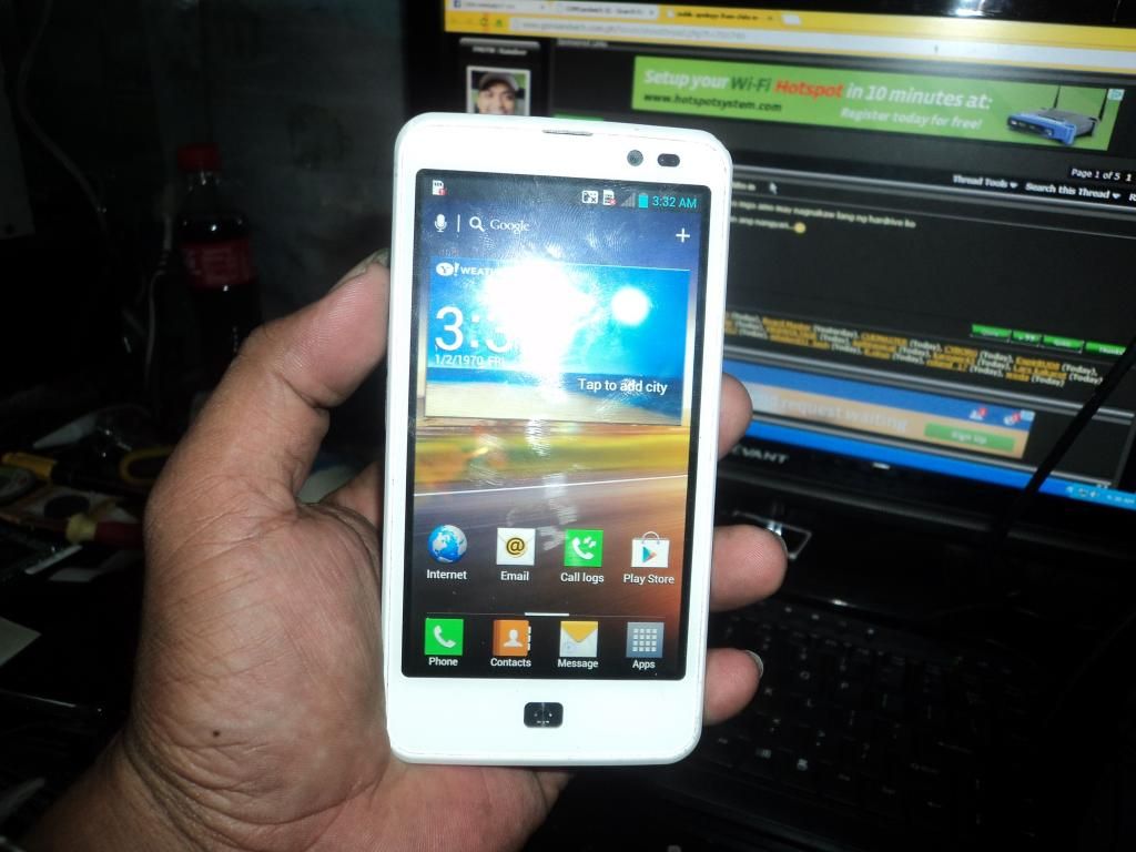

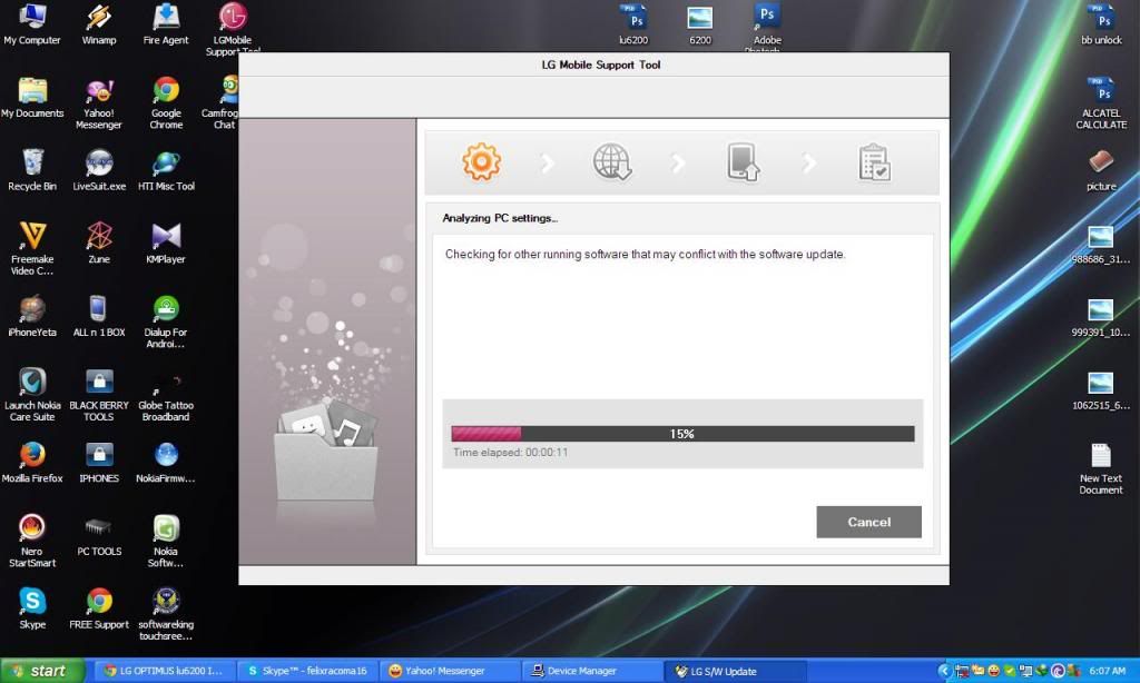

download update LG
volume down or up then insert mini usb then power on
already done
tolls -riff jtag
deadboot problem
hang logo stock
download update LG
already done
