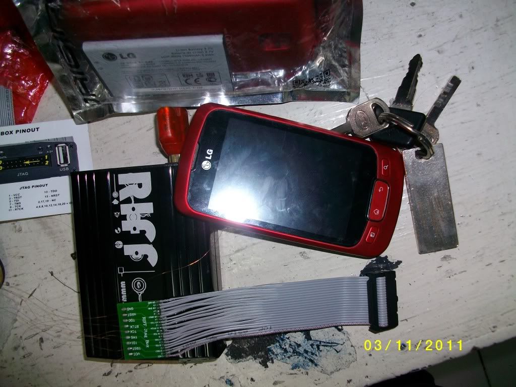

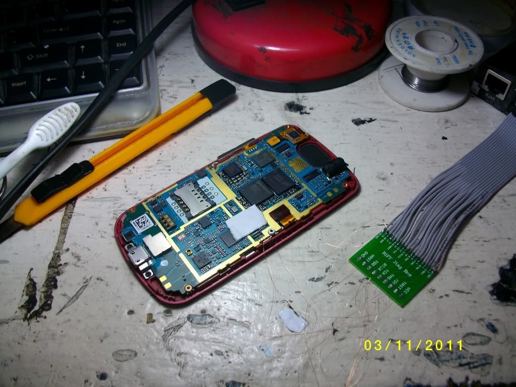

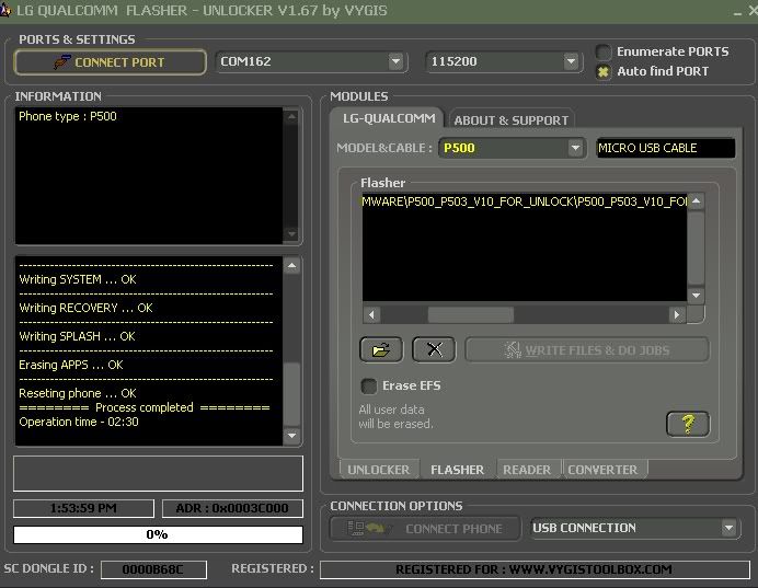

Open the unit and solder the wire..

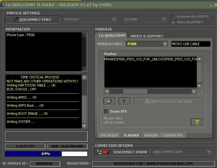

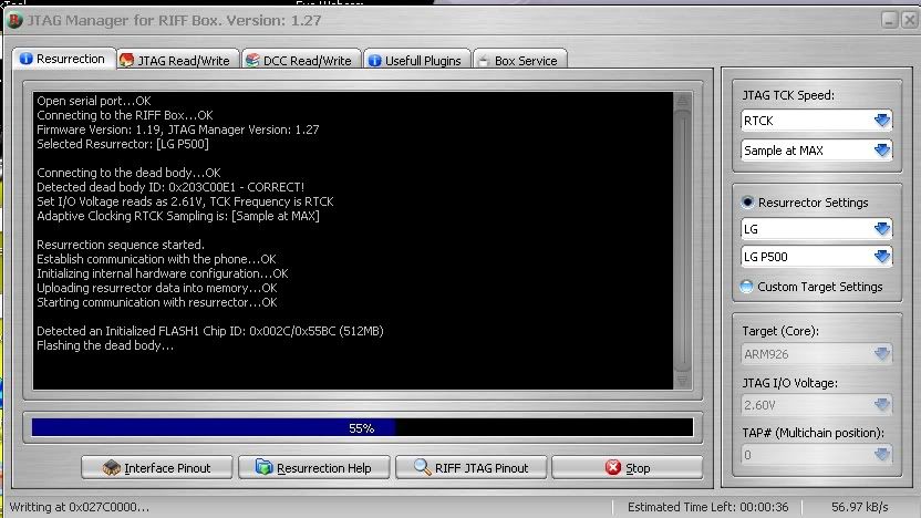

Open the software and connect the phone to the box, choose CORRECT MODEL.

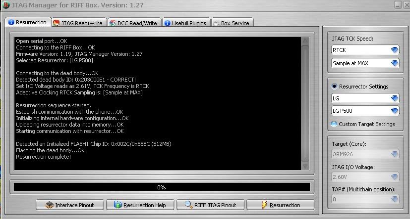

then hit the RESURRECTION Button
Wait untill finish...
flashing
pinout mejo mahirap ang pinout ang liliit nd tulad ng HTC kitang kita buti nakuha sa jaga

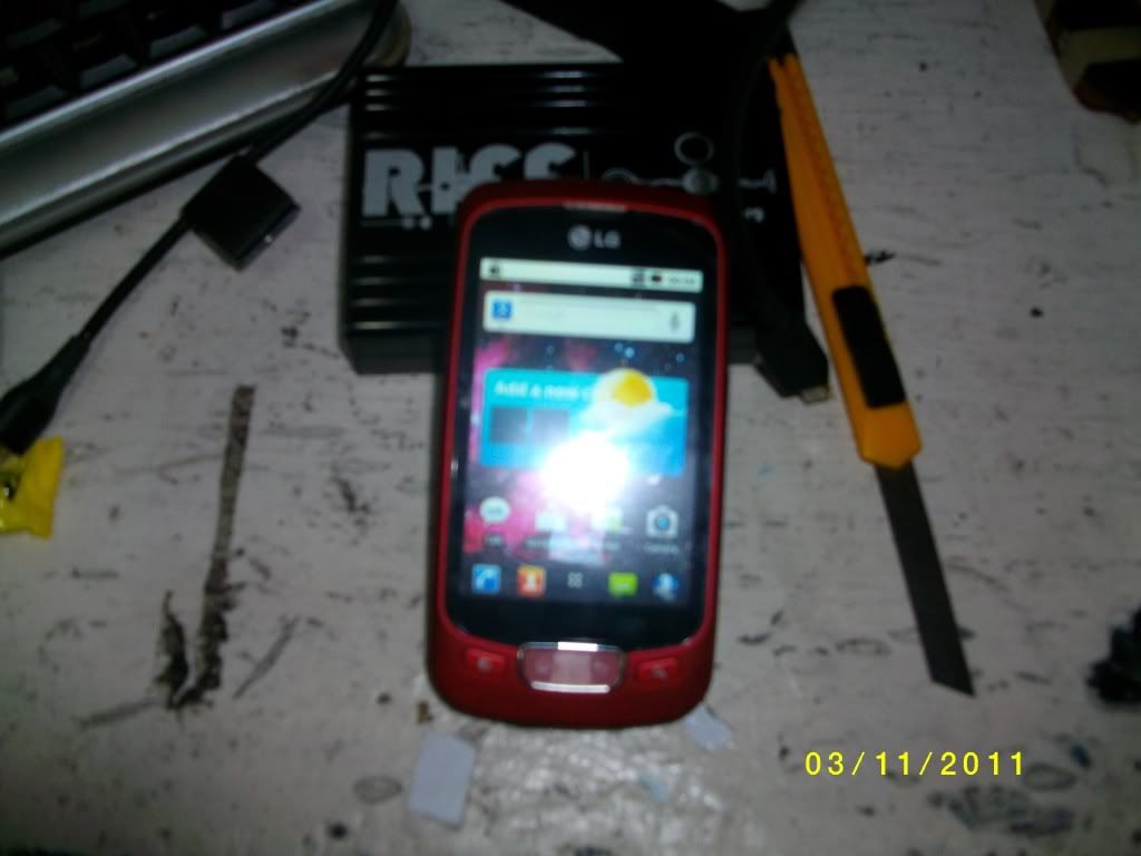

finish
