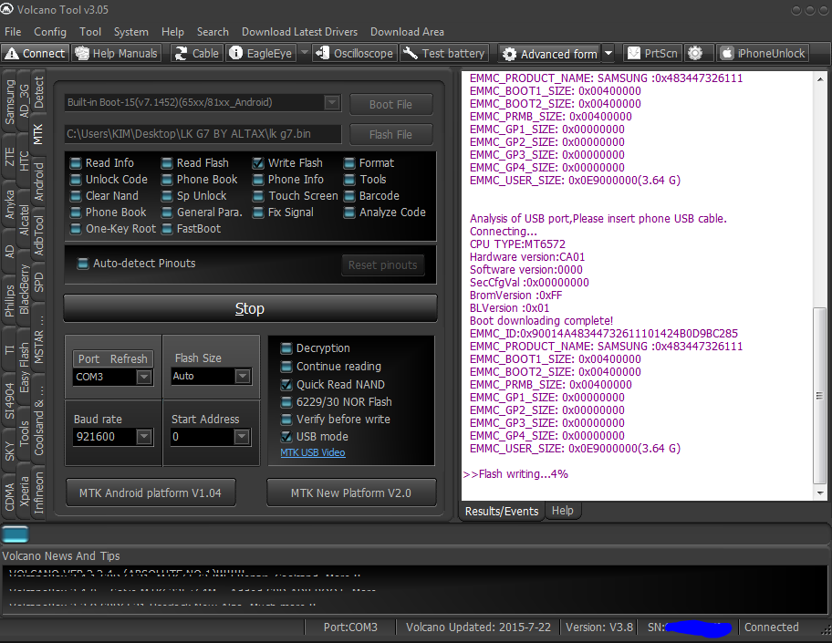

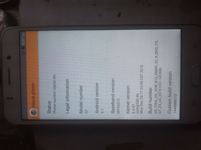

LK G7 blue screen only done in volcano
then pag charge steady lang at parang di nagkakalaman
hard reset ko no luck kaya proceed n s flashing
wala ako makia scatter kaya
thanks kay boss ALTAX para sa tested bin file
http://www.antgsm.com/showthread.php?t=88166&highlight=g7
procedure.
open volcano tool
select boot 15
uncheck auto detect
check usb mode
load flashfile( inedit ko file name kasi di madetect ng volcano nilagyan ko ng .bin)
then write flash

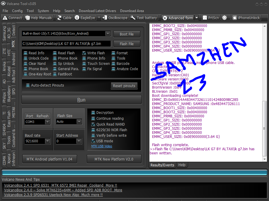

click run
hold vol up & down insert usb cable
wait until finish

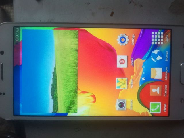

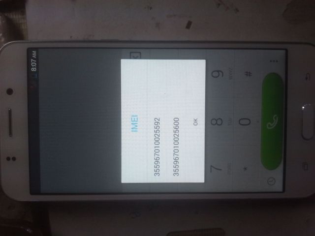

done

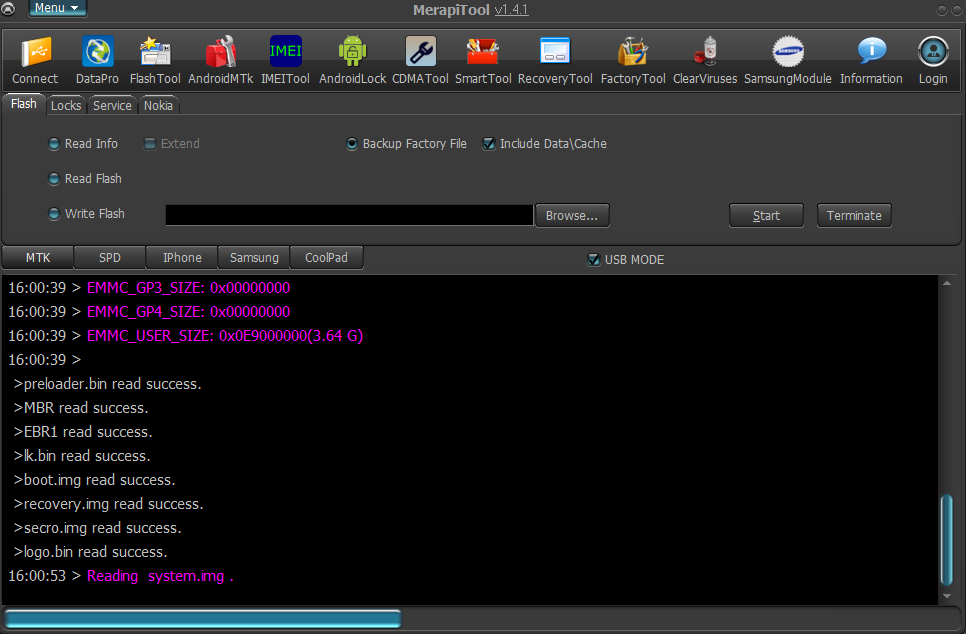

eto binack up ko na po scatter file para sa spft
