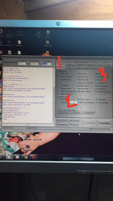

password issue no hrd reset kaya n luck,, spd pala xa, SC6875C
wala solution sa tahann kaya gwa ako paraan yaw din sa readinfo ky miracle crack
baklas ko muna para malamn ko kung ano cpu
then sundan lang po open miracle crack
1 power on your phone wala pipindun kahit no
2 salpak usb

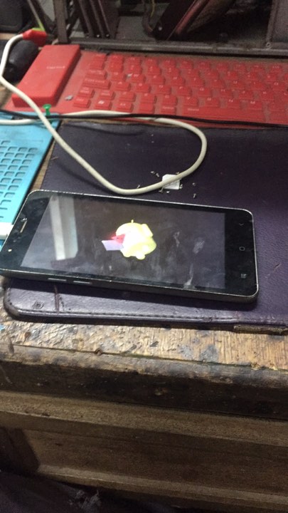

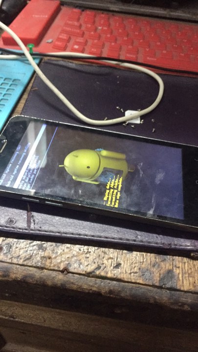

3 start muna kusa na mg recover modeyan
done
thannks for viewing
