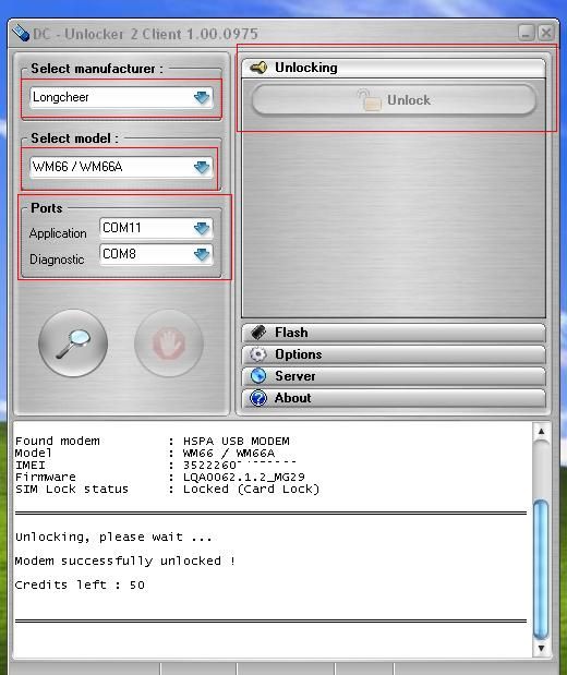

vygis toolbox (dc unlocker activated)
procedure
1. connect vygis toolbox
2. open dc unlocker software
3. select brand longcheer
4. select model wm66/wm66a
5. select correct application and diagnostic com port
note: b200w gamit kong modem, disconnect ko muna for detection after ma detect konek ulit then thick unlock
no credits consume for dc unlocker activated box

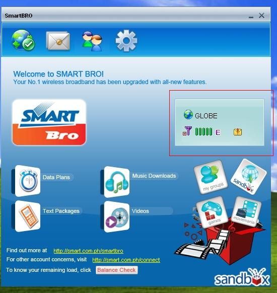

screen shot!

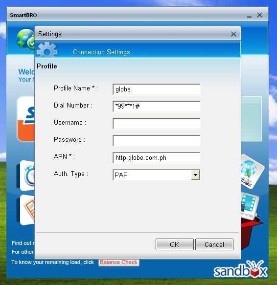

with globo bug sim
edit connection setting
sa mga may dc unlocker activated box
check this para malaman kung ilang credits ang ma consume
http://www.dc-unlocker.com/buy/dongle_price
