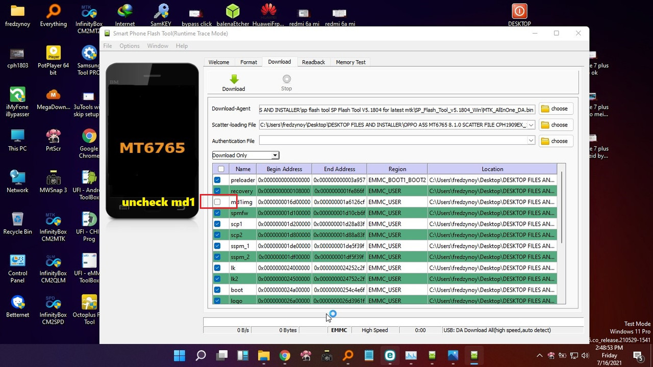

Sino po dito ang makapag Flash ng OPPO A5s mga boss? u have unit here, Oppo A5s stock on LOGO. Sana po mai maka tulong. I have done, factory reset through MRT and on Recovery but no Luck.
dl firmware https://www.mediafire.com/file/7jwai7t70ytndgi/OPPO_A5S.rar/file
gamit din mct tool for authorize bago isalang sa sp flash tool gamitan muna mct tool
https://www.mediafire.com/file/f336ivefw6kn68w/MCT_MTK_BYPASS.7z/file
load file sa sp flash tool at iuncheck ang md1 file tsaka iflash
latest sp flash tool gamitin..ctto
