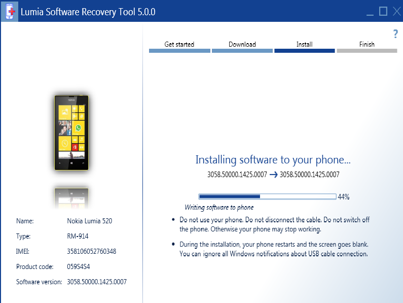

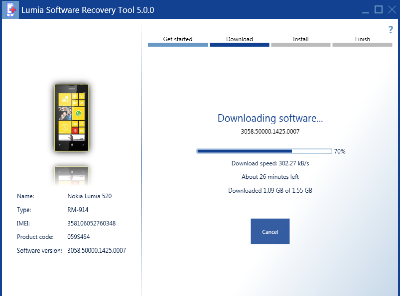

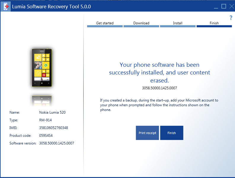

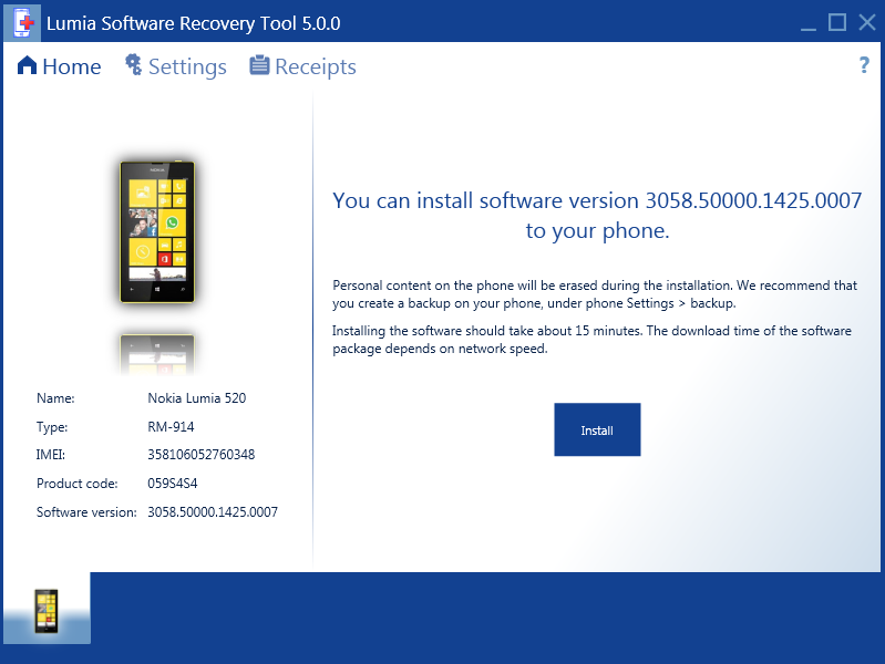

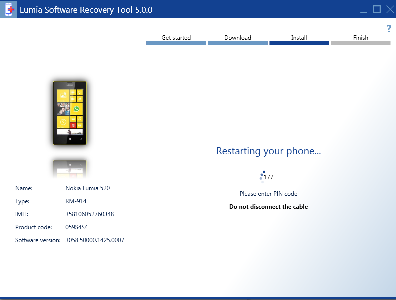

mga idol share ko lang tong ginawa kong
LUMIA 520
Problem: Black Screen pero kita yung dispaly ng Battery at signal
History: Reset daw ni Tomer
Solution: Software
1st DL this
DOWNLOAD LINK HERE
then install
after ma install open nyo lang po yung program..
turn on your cp then insert usb
after po madetect yung cp
click install then wait
wala nga lang po ako SS nung Lumia 520
For Reference Only
