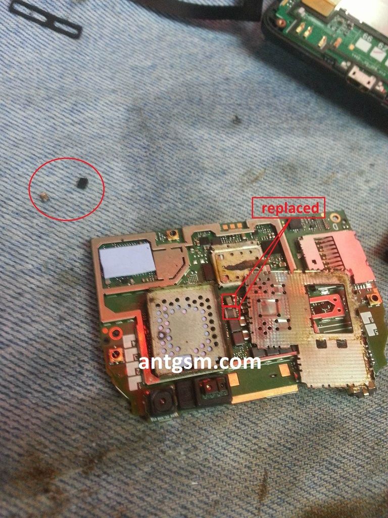

nabagsak daw then pag power on vibrate nalang daw
Action taken
check ko nag power naman but vibrate lang detected sa pc
then disassemble ko unit try bagong lcd may display pero
walang backlight check ko dito Lumia 625 light ways
ok naman lahat ng connection so replaced ko ung coil at capasitor

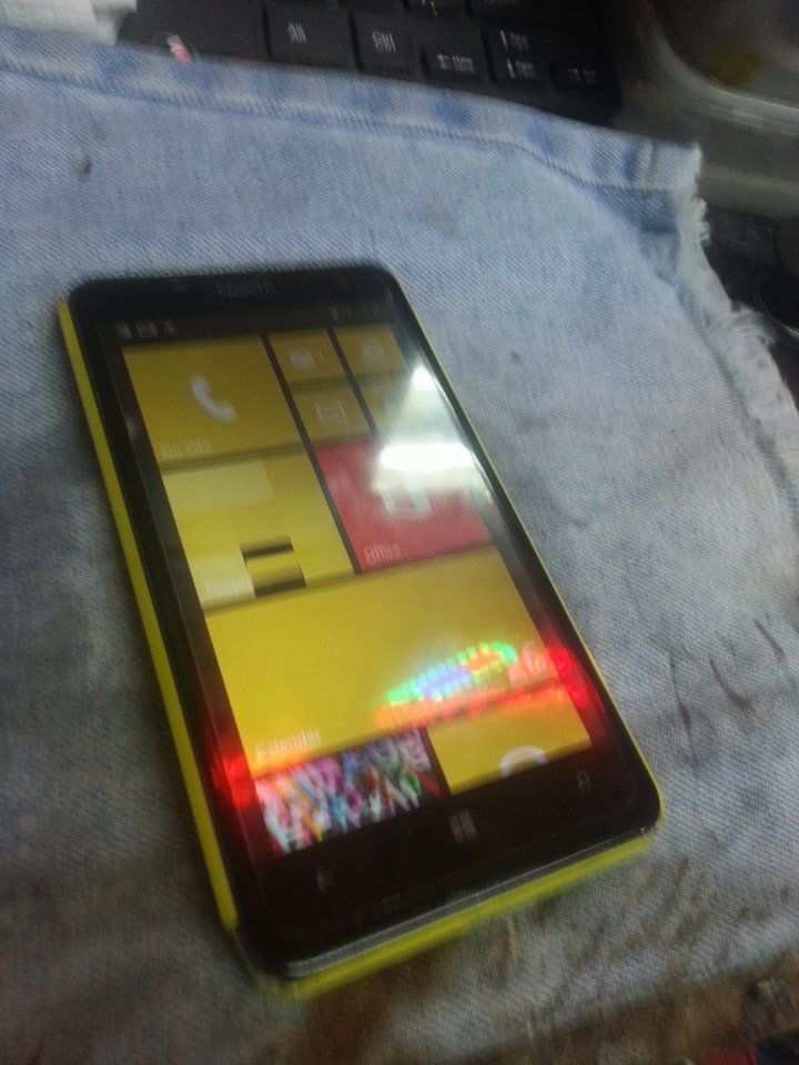

image boomm.. :D:D
Done...!
