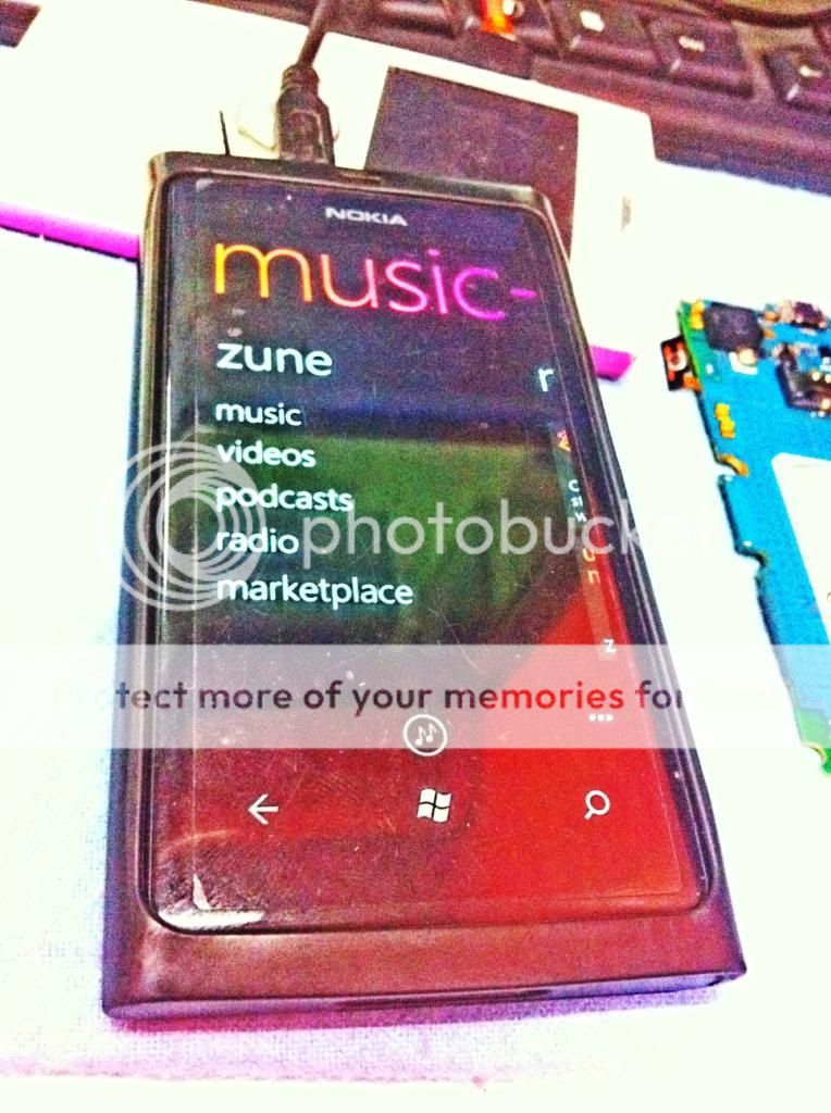

unit: lumia 800
status: di ma-open ang music at market

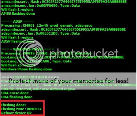

solution: flash ang phone gamit ang crack nokia best tool

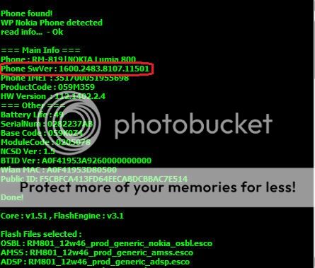

original version:
flashing done:

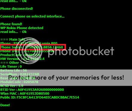

updated version:
voila :
