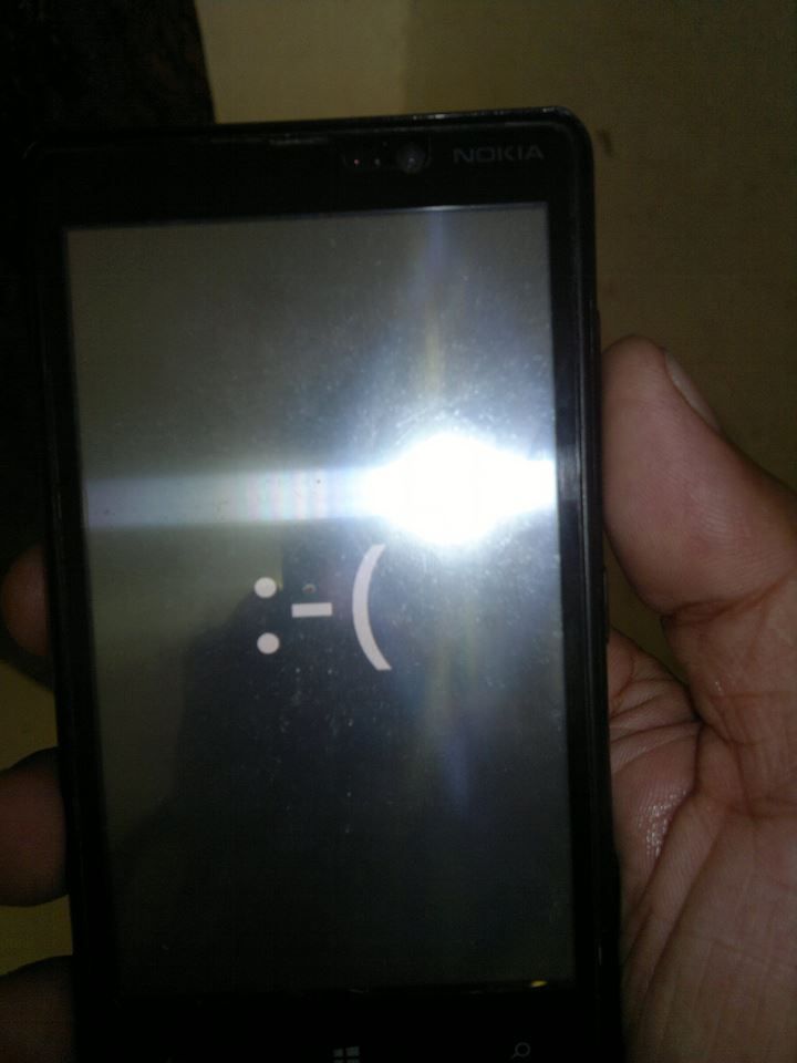

Lumia 820 rm-825 Hang
Ganito ang status ng cellphone pag dating sa akin..

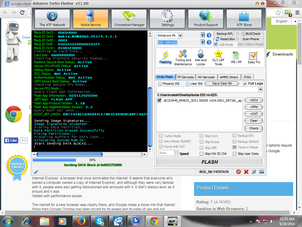

ito ang mga ginawa ko..

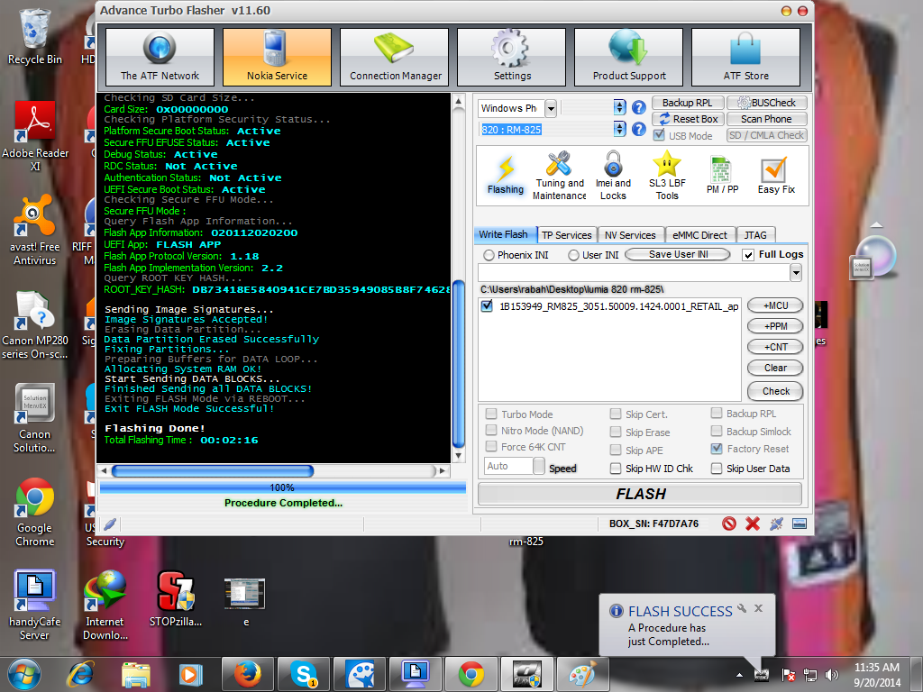

Download fermware.. lumia firmware
open/ATF/WINDOWS PHONE/MCU/SELECT/FERMWARE/FLASH
HTML:
  1. Power On the Phone and Connect it to the USB Port
If the Phone is DEAD
  1. Connect Phone to the USB Port
  2. Press and Hold the VOLUME DOWN and POWER Buttons
  3. Wait until the Phone Vibrates Shortly...
  4. Stop Pressing the Buttons...

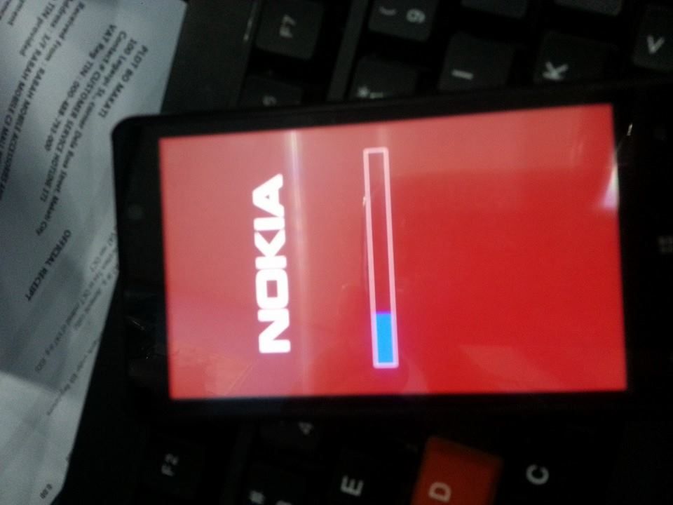

Habang mag flash ang unit ito ang makita mo.

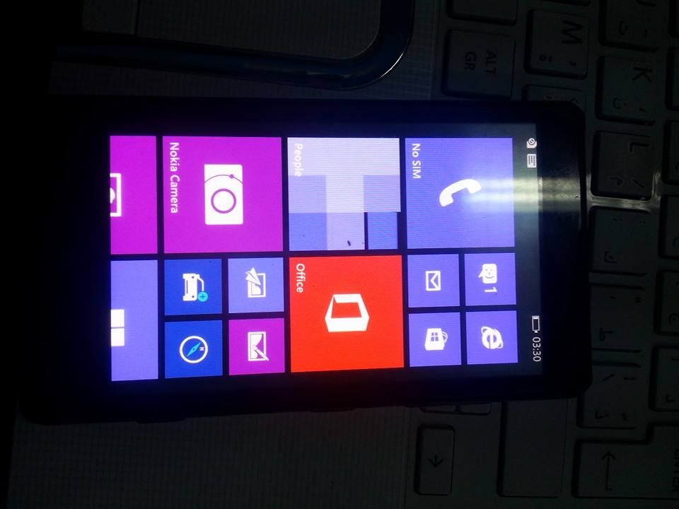

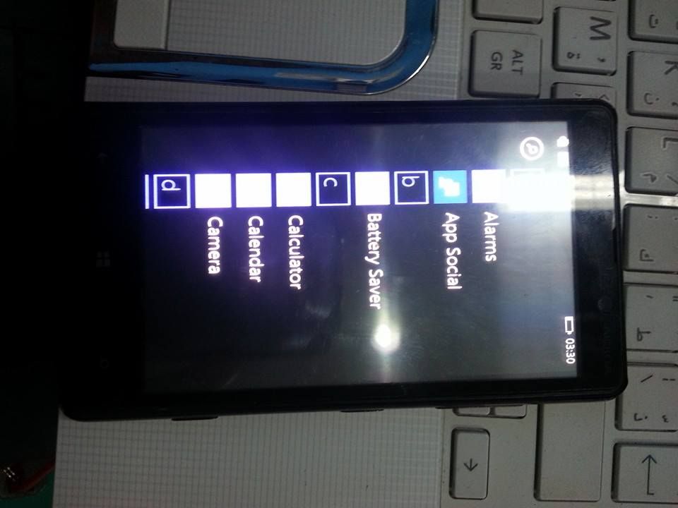

DONE
