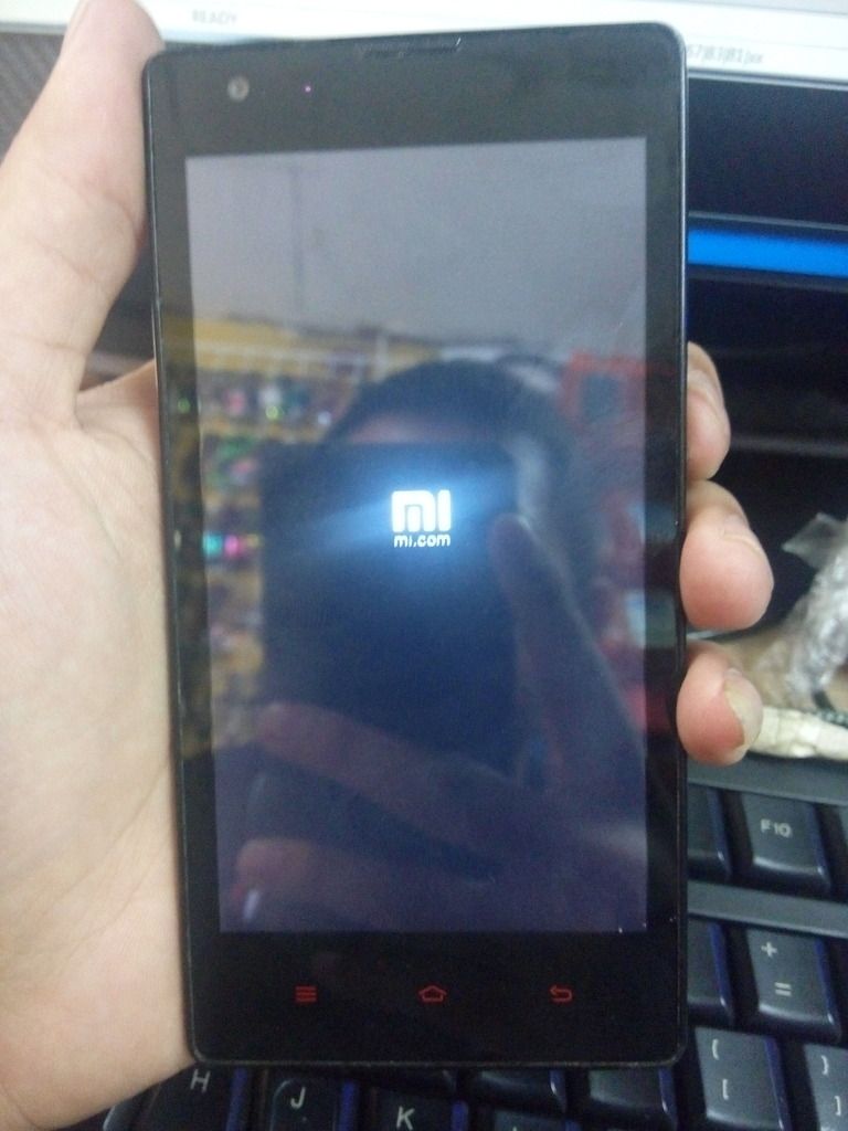

SHARE KOLANG NA REPAIR KO NGAYON BAKA MAKATULONG SA BAHAY NI KUYA
M-I Model 2013023 hang logo done by cm2
:-w CLICK MO TNX BOTTON KUNG NAKATULONG SAYO
DONE
