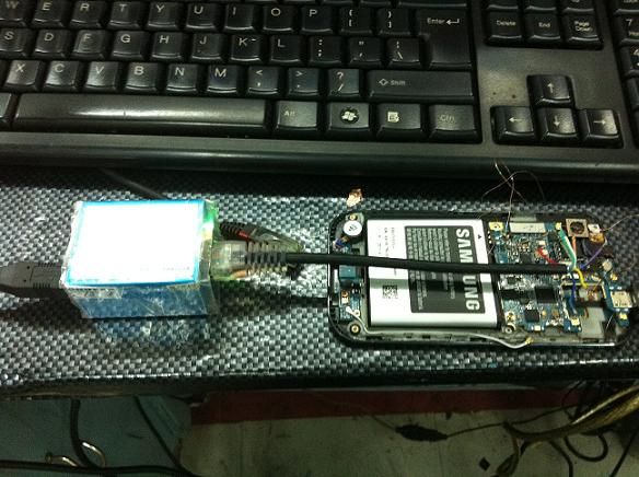

Model:
  • M110 Anycall
Problem:
  • NoPower/Deadboot
Action Taken:

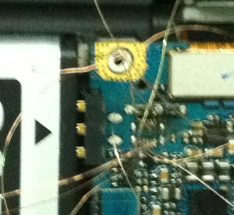

Code:
  • Solder Pinout

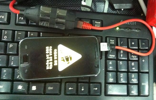

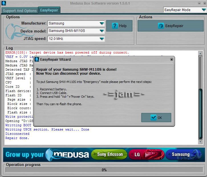

Code:
  • EasyRepair Mode sa Medusa Gamit ang Repair.mf.

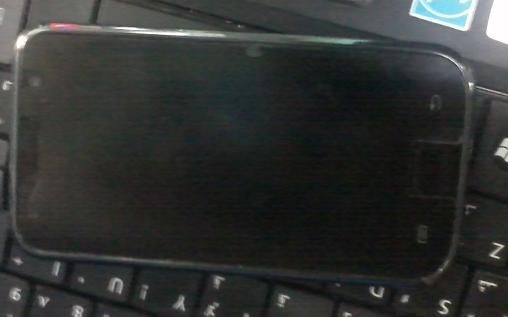

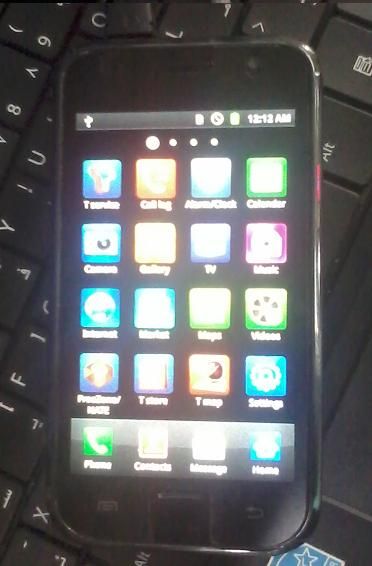

  • Buhay na kaso scrumble ang display
Solution:

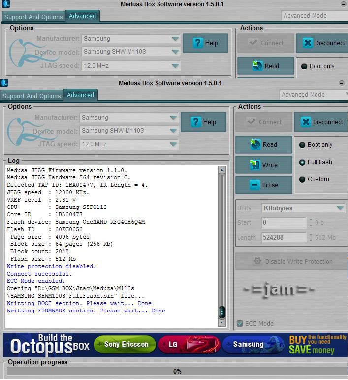

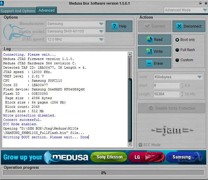

Code:
  • Select Advance Mode
  • Connect
  • Select Full flash
  • Write SAMSUNG_SHWM110S_*********.bin & wait up to 3hrs
  • Test it if may DL mode na
  • Pag wala parin select Boot only then write
  • Done
