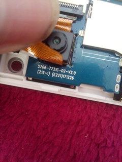

M706AA Board Id: s706-7731c-d2-v2.0 vibrate only done

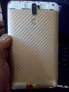

STATUS NG TAB VIBRATE ONLY
KAKABILI LANG DAW NI TOMER 3DAYS
LANG DAW ANG WARRANTY AYAW NG PALITAN
NAPADAAN SA SHOPPE AT USAP MUNA HANGGANG SA
MAGKASUNDO SA PRESYO

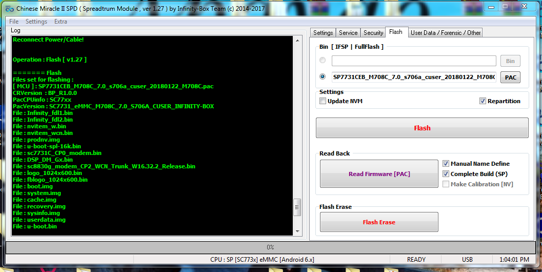

NAGHANAP AKO DITO SA TAHANAN AT
HINDI AKO NABIGO SHOUT OUT KAY
BOSS AGS SA KANYA KO NAKUHA ANG PAC FILE
NA GINAMIT KO....
http://antgsm.com/showthread.php?t=164638&highlight=S706-7731c-D2-v2.0
BOARD ID:
FLASH KO ANG YUNIT CM2 SPRD SELECT
SP7731 6.0

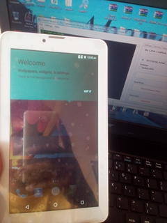

uploading images
ITO NA ANG YUNIT AFTER DONE
SA FLASHING
imag
FOR REFFERENCE MGA KA ANT
