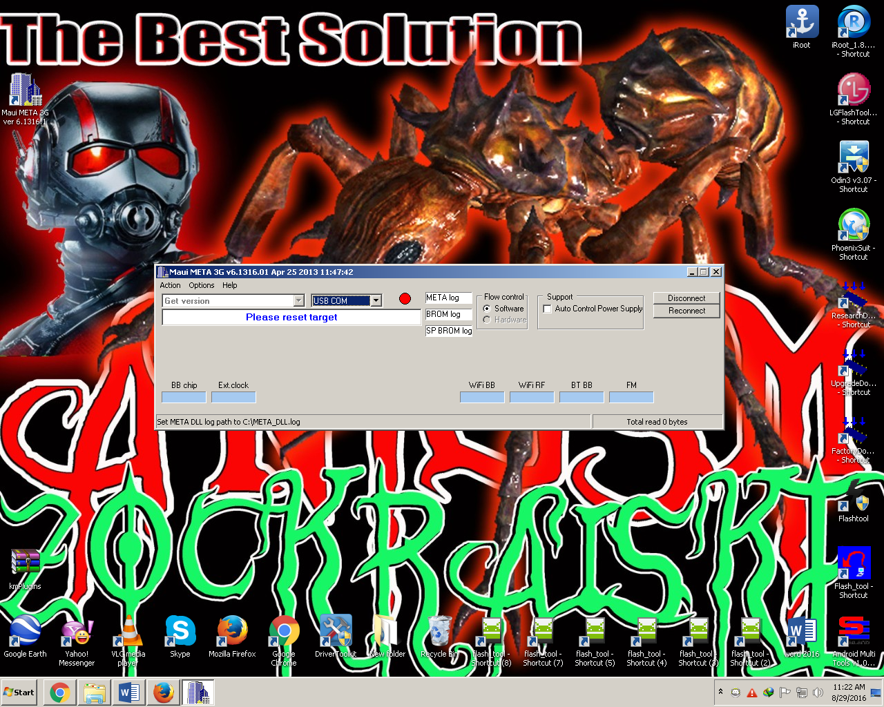

Maui META 3G ver 6.1316.1 IMEI Tool
Things You will Need :
Team Kustoms One pack solution for IMEI fix ( everything included )
Adb Drivers ( Included )
All download links given below .
So lets get start :
Method 1. ( NON ROOT METHOD )Step 1. Turn you phone Off ( install adb drivers and first check if all drivers are working . )
Step 2. Download and extract the pakage given below ( team kustom's IMEI package . )
Step 3. Install the Meta software given in the package .
Step 4. Open it ( make sure to run it in admin mode - run as admin )
Step 5. Select IMEI download as shown in images below .
Step 6. go to options and select the second option ( shown in images )
Step 7. Click on reconnect and connect you phone via USB ( do not turn it on . keep your phone turned off )
If this doent work then please remove battery and connect and turn the phone on .
You will see a popup relating IMEI tool . Now select the first option ( download Flash file ) and browse the BPLGU file which is in the package
Note : Other phone owner ( other than android one ) can search their BPLGU file in the ALL_MTK_BPLUG zip . This is special file for android one device .
Step 8. Now write both SIM imei ( check your mobile box for it or behind the battery - Writing wrong imei is illeagal )
Step 9. Click on second Option ( update flash file ) and close the imei tool.
Step 10. click on disconnect and turn your phone on . WTF you are on network back :P
