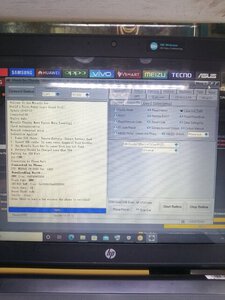

nakalimutan dw ni. customer ang linagay nyang privacy code kahit e hard reset mo bumabalik parin sa privacy code
kaya ito ginawa ko
1st open Miracle Thunder 2.82
2nd select MTK then click Unlock/fix
3rd click Clear Ant Theft
4rth Boot select 8th Boot(MT65xx & MT67xx/8127)
5th hold volume up to boot and click start

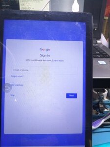

sa frp naman click Extra then select Frp Remove

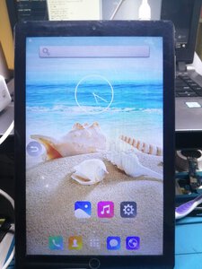

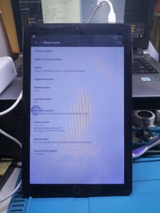

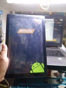

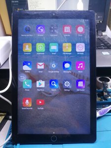

ito prove pic
