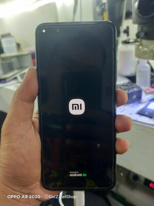

Xiaomi Mi 10T Pro 5G No power FIXED!

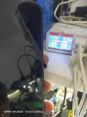

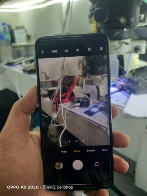

Upon diagnostic mapapansin natin low current charging sya sa schematic charger (0.10mA)IMG20230214141537.jpg

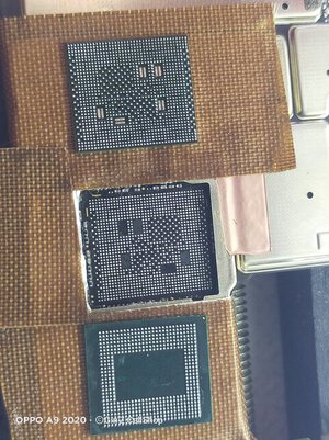

ilang beses ko na to na encounter basta sa ganyan reading it means may faulty sa connection nang CPU at RAM sa motherboard

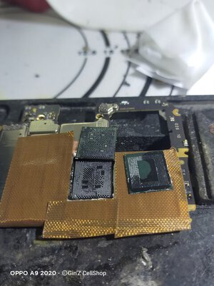

so proceed na tayu sa CPU at RAM rework
CPU and RAM removal
Heat 380° Air 60

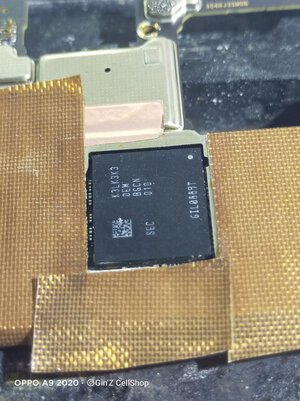

CPU and RAM installation
Heat 380° Air 35
Reballing Paste use - 158° mid temp

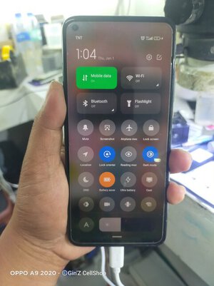

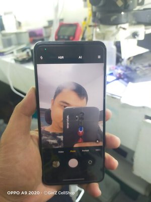

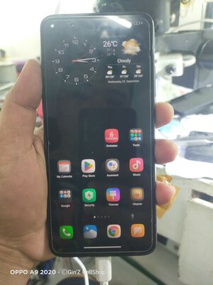

Successful Result
IMG20230214171820.jpgIMG20230214172038.jpgIMG20230214173012.jpgIMG20230214173021.jpgIMG20230214173328.jpg
All functions working fine :cool:
