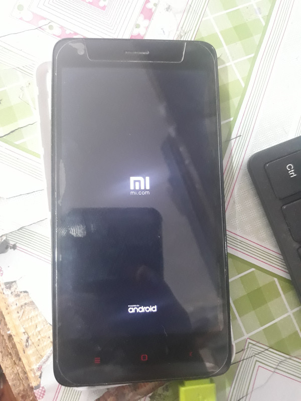

xiaomi redmi 2 (2014816)
problem restarting sa logo ng MI

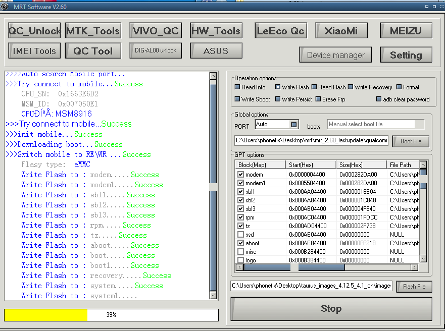

try ko muna mi flashtool no luck error
try ko secret tools still error
try ko mrt dongle nagflashing pero bandang dulo napuputol

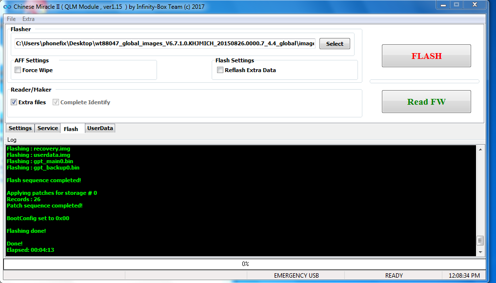

last try cm2 ayun nag diretso
procedure
download muna firmware dito
http://frimware-android.blogspot.com/
hanapin nlng yung model redmi 2
open cm2qualcom
load firmware
insert usb
intall driver if needed
then click flash
wait until finish
screenshots

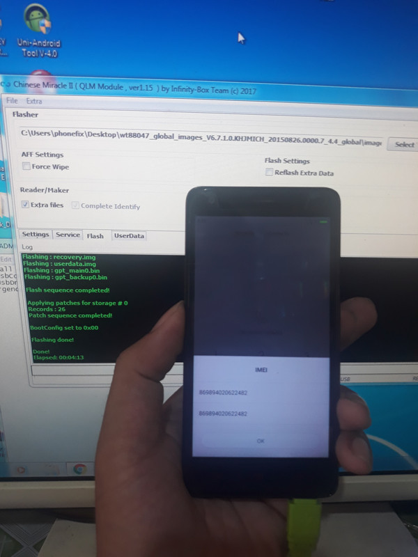

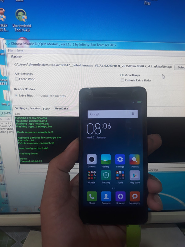

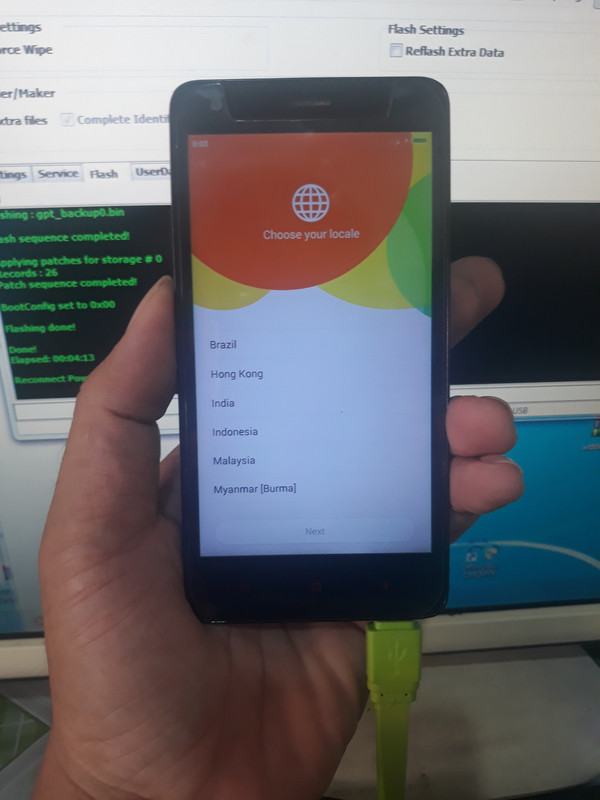

flashing done
imei ok
