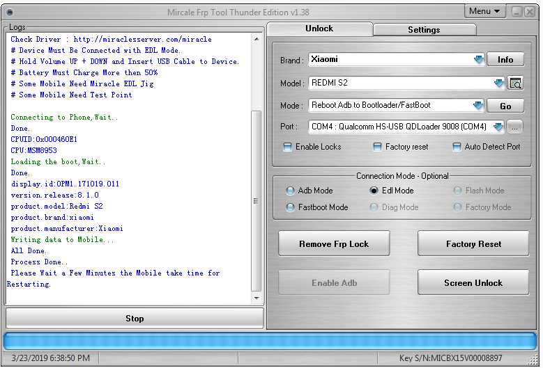

share lang mga idol Mi Redmi S2 version 8.1.0 FRP lock Remove Done by miracle frp tool

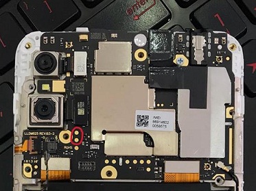

kailangan naka testpoint
open natin miracle frp tool
select brand xiaomi
select model Redmi S2
testpoint natin para makita qualcomm driver na 9008
click remove frp lock
hintay matapos
done na
pagkatapos remove frp
open ninyo secret tool i fix lock ninyo account mi para hnde maglock kapag mag wifi c tumer
