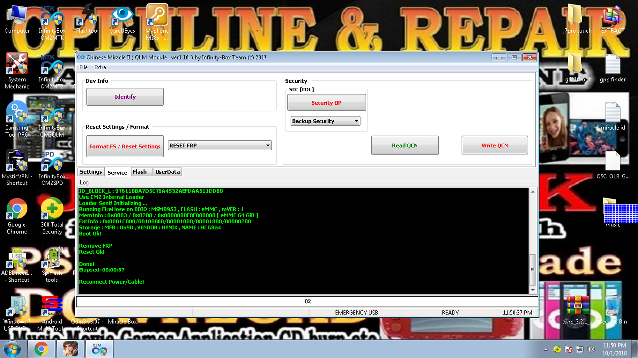

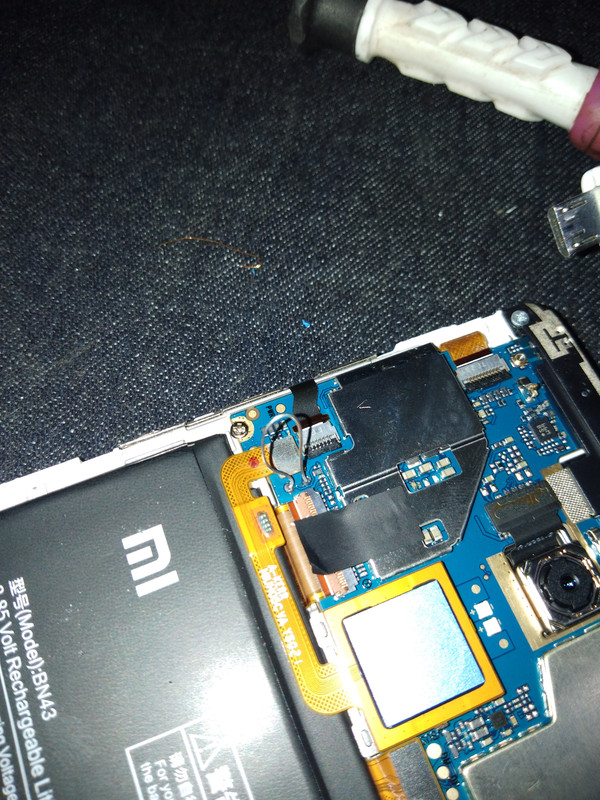

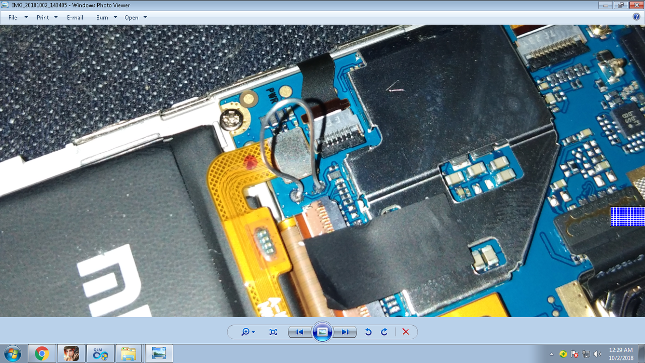

share ko lang mga boss xiaomi naka frp buksan unit kailangan jumper para mag connect
pag na jumper na kahit wag na lagay battery open cm2 QLM sundan lang hold volume up tapos connect usb
pag ok na remove jumper tapos pera na pwed rin yan sa mi account select mo lang XIAOMI:RESET ACCOUNT
DONE:D:D:D
