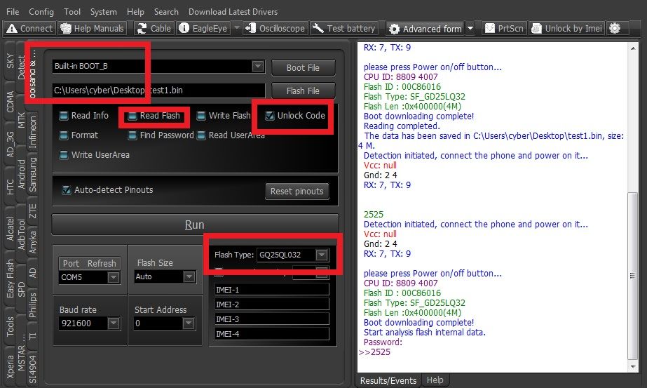

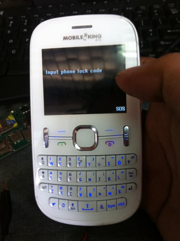

Problem
Phone Lock nalimutan ung password
Action Taken
Use volcano box to remove password
Procedure
1. select Coolsand&rda tab
2. set Flash type in GQ25QL032
3.Check unlock code

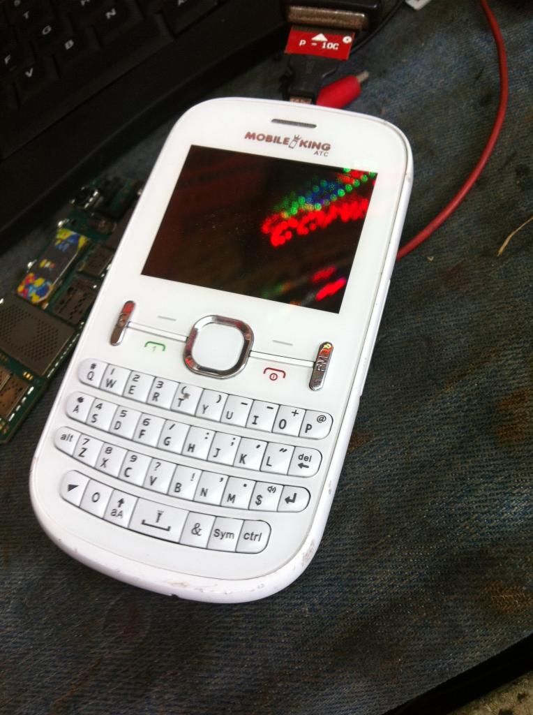

4. select Run/ press power button
DONE
