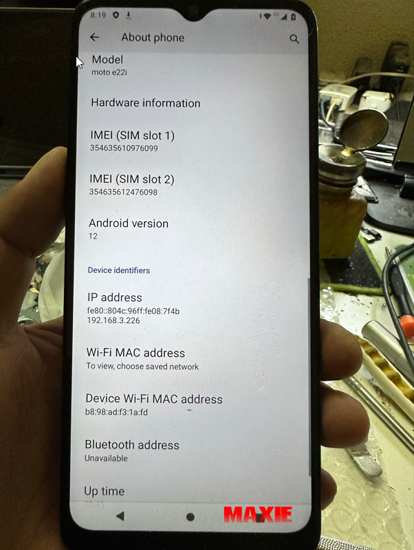

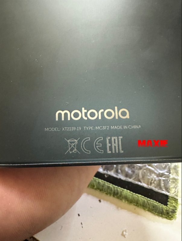

Unit:
Motorola E22i
Model: XT2239-19
Problem: FRP or Google Account
solution: Unlock via FRP Tool via test method
Tried in another tool and the result was fail

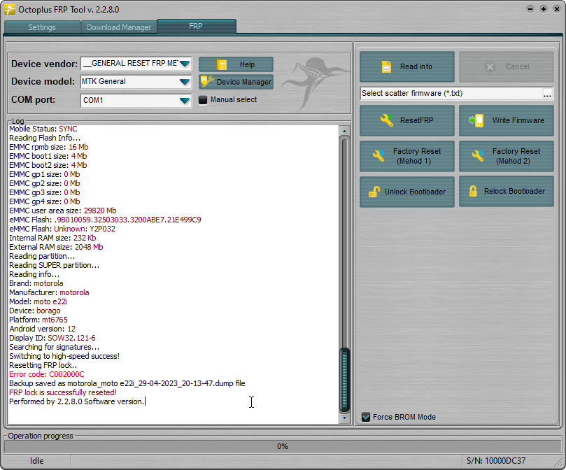

Procedure Via Test Method
  • Open FRP Tool
  • General Reset FRP method
  • MTK General
  • Click Reset FRP
  • Hold Vol + and Vol -
  • Connect Cable
  • wait Until Finish
  • Done
Work ID: 000000000191DB07
Platform: __GENERAL RESET FRP METHODS
Selected model: MTK GENERAL
Please, reconnect battery, press and hold "Vol+" or "Vol-" button and connect USB cable.
Searching for a phone. Please wait...
Found phone on COM38
Port name: MediaTek PreLoader USB VCOM_V1632 (Android) (COM38)
Detecting Chip Version...
HW Chip: MT6765: 0766.0000
HW Version: 8A00.CA00.0000.0000
Brom Version: FF
Trying to crash...
Found phone on COM39
Port name: MediaTek USB Port_V1632 (COM39)
Brom Version: 05
Connecting...
Target Config: 00E5
BootLoader Version: FE
Brom Version: 05
Disabling protection...
Reconnecting...
Target Config: 0000
Reading preloader...
Searching Download Agent...
Selected DA: MTK_AllInOne_DA_v3.3001.11/28/2021.05:37_580390, n.20
Sending Download Agent...
DA sent successfully
Initializing DA...
Synchronizing with DA...
Mobile Status: SYNC
Error code: C0010004
Mobile Status: brom
Sending BootLoader Info...
Initializing Memory Flash..
Initialization successfully completed
Sending loaders...
Mobile Status: SYNC
Reading Flash Info...
EMMC rpmb size: 16 Mb
EMMC boot1 size: 4 Mb
EMMC boot2 size: 4 Mb
EMMC gp1 size: 0 Mb
EMMC gp2 size: 0 Mb
EMMC gp3 size: 0 Mb
EMMC gp4 size: 0 Mb
EMMC user area size: 29820 Mb
eMMC Flash: .9B010059.32503033.3200ABE7.21E499C9
eMMC Flash: Unknown: Y2P032
Internal RAM size: 232 Kb
External RAM size: 2048 Mb
Reading partition...
Reading SUPER partition...
Reading info...
Brand: motorola
Manufacturer: motorola
Model: moto e22i
Device: borago
Platform: mt6765
Android version: 12
Display ID: SOW32.121-6
Searching for signatures...
Switching to high-speed success!
Resetting FRP lock..
Error code: C002000C
Backup saved as motorola_moto e22i_29-04-2023_20-13-47.dump file
FRP lock is successfully reseted!
Performed by 2.2.8.0 Software version
