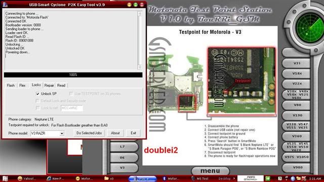

Free Unlock with USB-SMART Cyclone P2K Easy tool v3.9[/size]

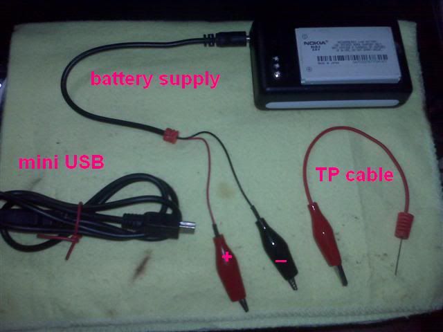

TOOLS:
1.Mini USB cable for v3
2.Battery supply "modified"
3.TP cable "modified"

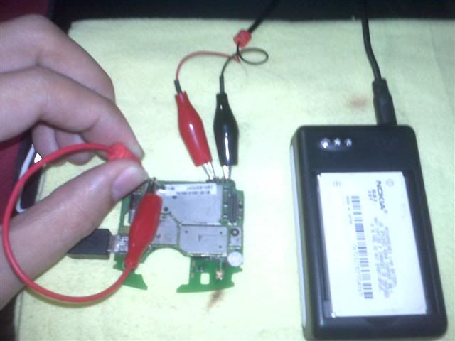

PROCEDURE:
1.Disasseble the phone
2.Connect USB cable
3.Refer to TP in photo
4.Open P2k tool
5.Go to Locks tab
6.Connect TP to ground
7.Connect Battery
8.tick Unlock SP and Do Selected Jobs
SCREEN SHOTS:
