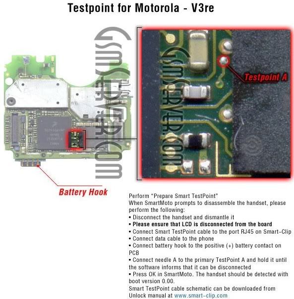

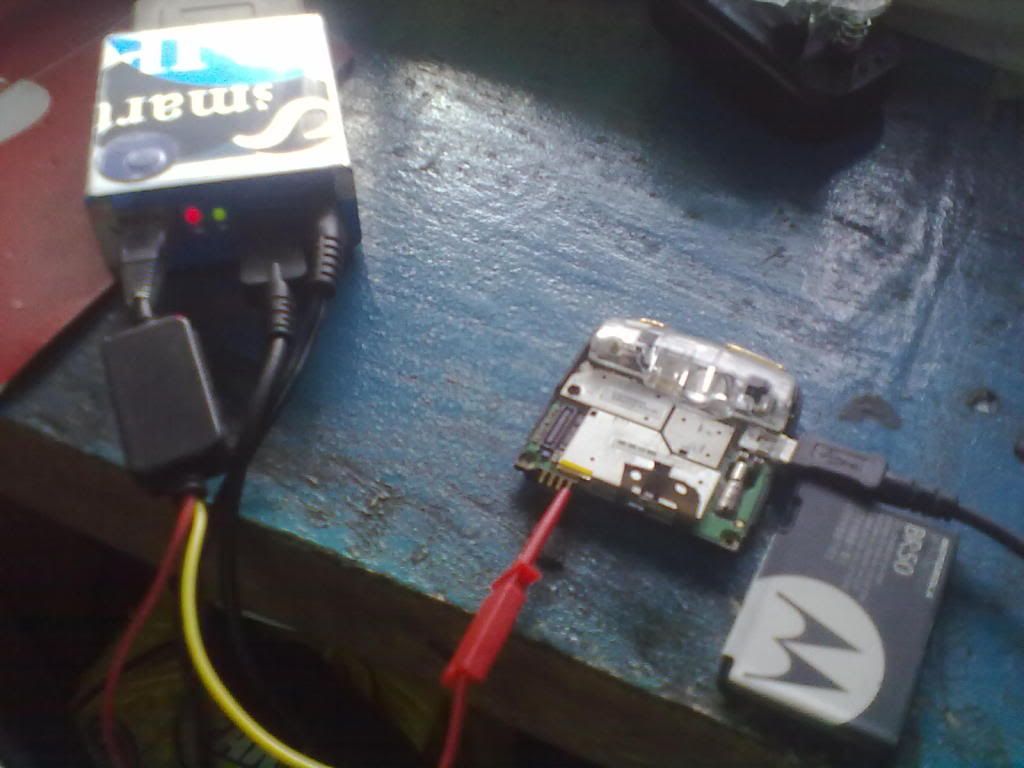

TOOLS:
Smart Clip
Scard
Smart TestPoint version 2.0
USB cable
PROCEDURE:
1: open smartmoto software
2: connect unit in normal mode
3: click 'SEARCH"
4: click Prepare phone Tab
5: select model
6: click Prepare phone
then follow procedure appears on the screen done

Tp pic.
done

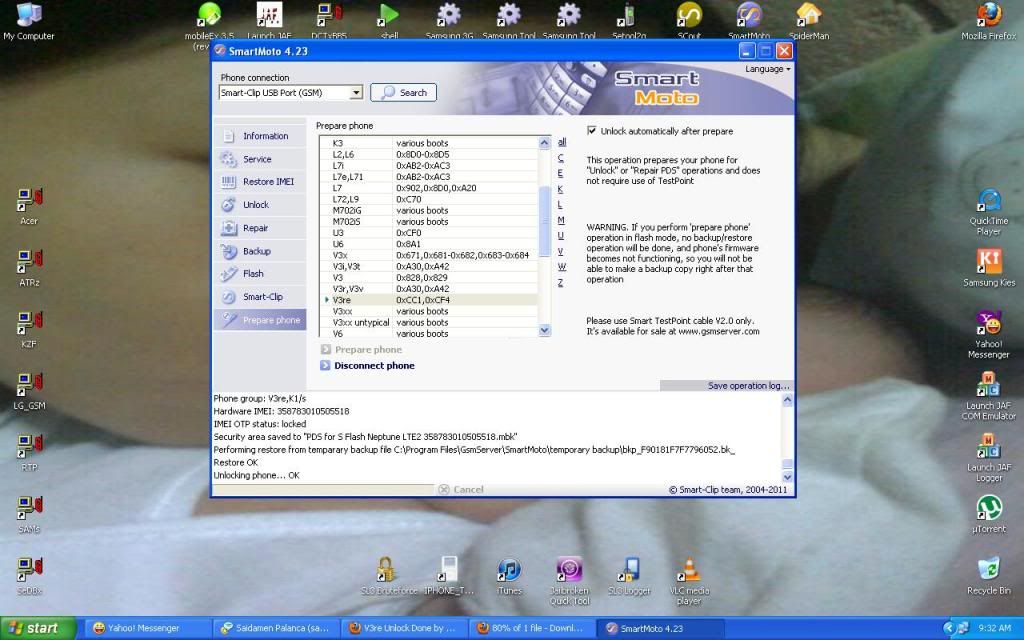

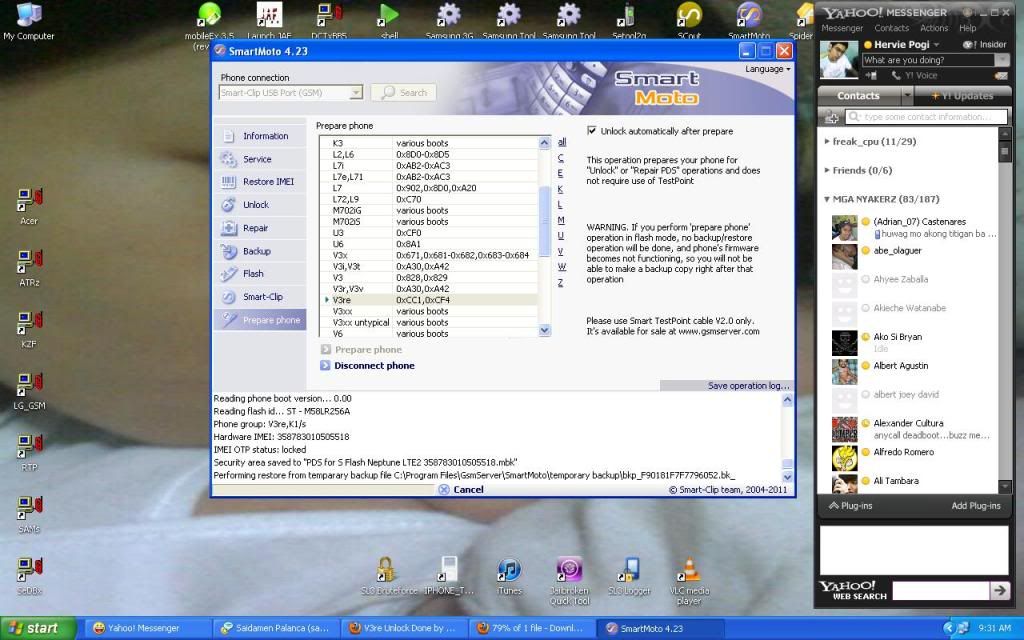

Searching for phone... found Motorola Phone (V3re), getting test interface... OK
Model V3re
Firmware R3442A_G_0E.43.04R_A
Switching to flash mode... OK [S Flash Neptune LTE2]
Reading phone boot version... C.C1
Sending boot... OK
Stored temporary backup to C:\Program Files\GsmServer\SmartMoto\temporary backup\bkp_F90181F7F7796052.bk_
Sending boot... OK
Erasing flash memory OK
Sending firmware OK
Searching for phone... found S Flash Neptune LTE2
Reading phone boot version... 0.00
Reading flash id... ST - M58LR256A
Phone group: V3re,K1/s
Hardware IMEI: 358783010505518
IMEI OTP status: locked
Security area saved to "PDS for S Flash Neptune LTE2 358783010505518 (1).mbk"
Performing restore from temparary backup file C:\Program Files\GsmServer\SmartMoto\temporary backup\bkp_F90181F7F7796052.bk_
Restore OK

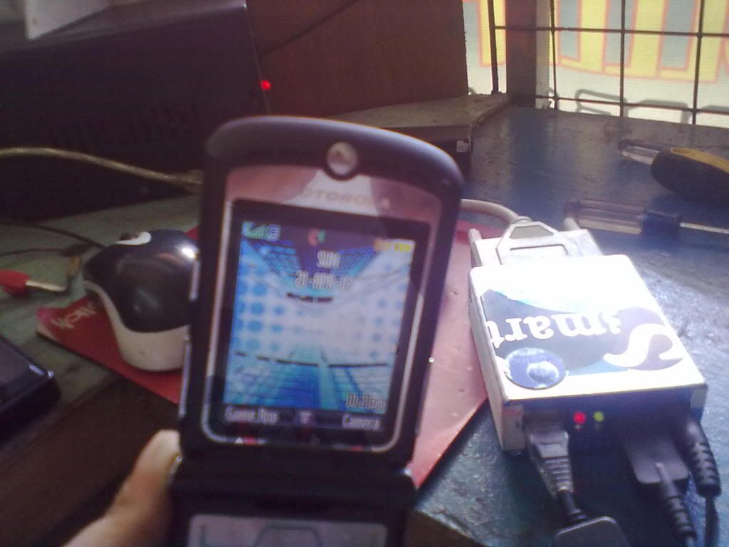

Unlocking phone... OK
unlock done
