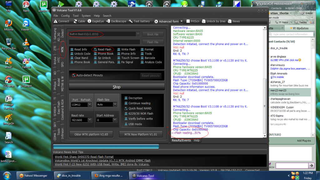

..open volcano exe\
..chose mtk

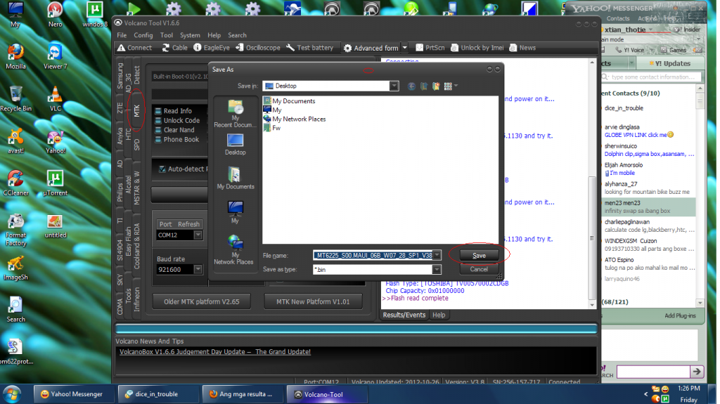

..chose built-in-boot-01(v2.1031)
..read flash muna para safe
..after ma read do format..
see picture for details...
Click this bar to view the full image.
save the file..

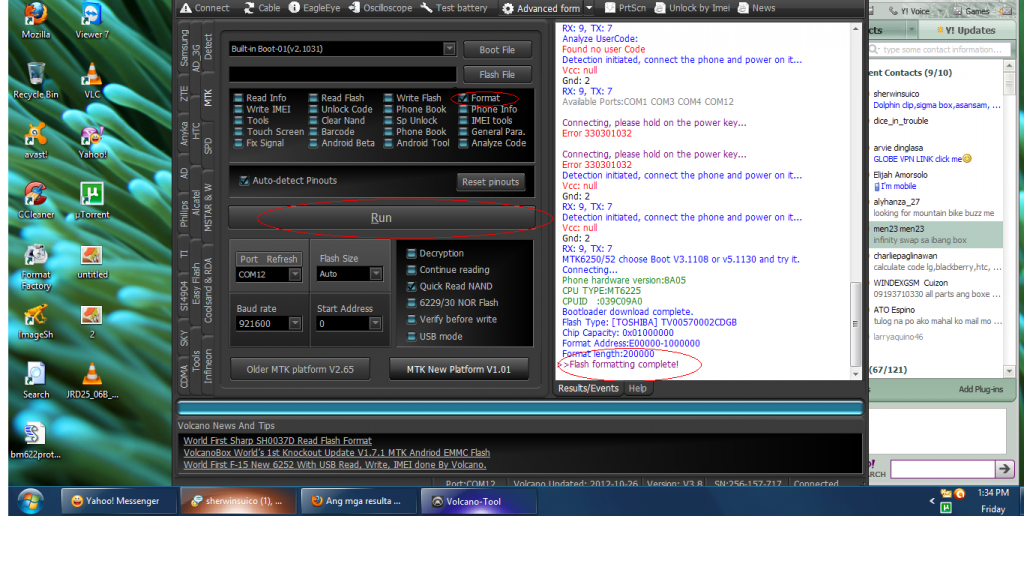

formating.....
after formating test ko ang unit kung buhay pa..
at ok naman ang unit buo pa imei..

..open volcano exe\
..chose mtk
save the file..
formating.....
