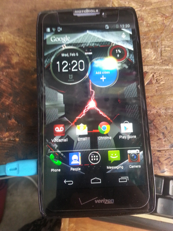

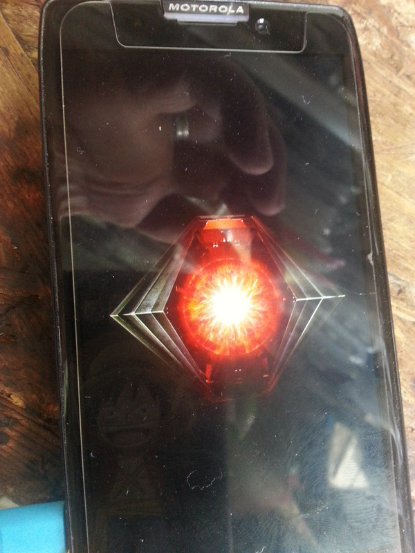

share ko lang po Motorola XT926 hang logo po xa nung dnla
try ko hard reset no luck kya proceed n po ako s flashing

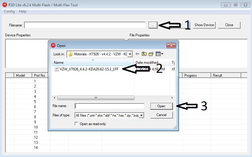

e2 po ung firmware at flasher n ginamit ko
nsa tatsulok n po ung pass
https://www.mediafire.com/file/1p5g...-_XT926_-_v4.4.2_-_VZW_-_KDA20.62-15.rar/file
e2 xa nung dnla sken

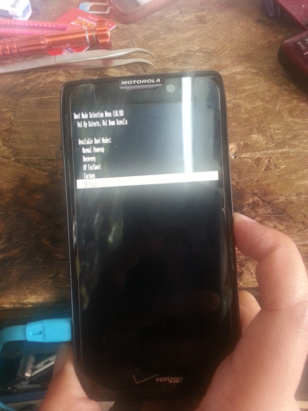

Press power, volume up and down sbay sbay hanggang lumbas to
at piliin po ung ap fastboot gmit ang volume up..

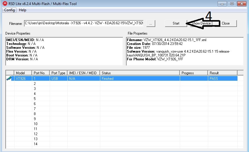

tpos po proceed n s flashing pkisundan n lng po ung nsa pic
after flashing po magrereboot xa tpos done n
