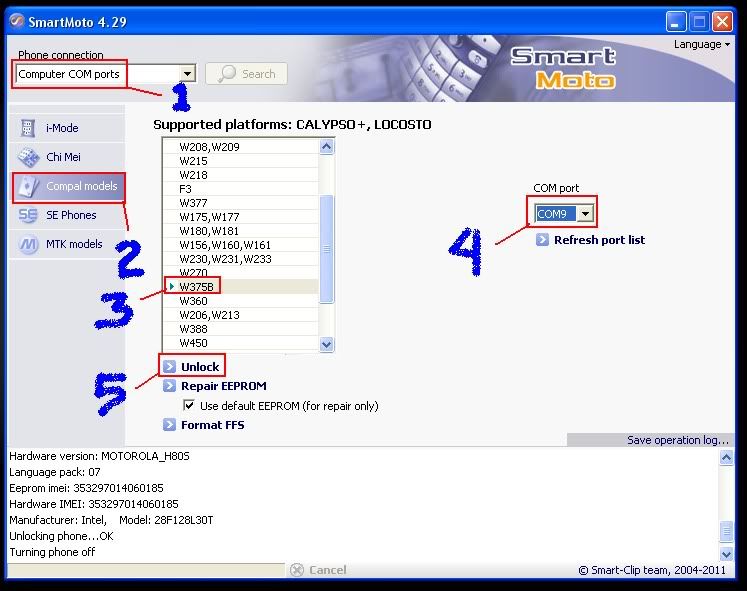

Motorolla w375 UNLOCK done via SMARTCLIP...
PROBLEM:
lock to all network
TOOLS:
smartclip w/ SD card,t191 usb cable
PROCEDURE:
Code:
* Connect* powered OFF phone to PC COM port. * Launch SmartMoto. * Select "Computer COM ports" in Phone connection window. * Log to "Compal" tab. * Select an appropriate COM port in SmartMoto. * Press "Unlock" button. * Press "Power ON" button on the phone, a s soon as SmartMoto indicates an appropriate message. * SmartMoto performs the Unlock process. * The handset is unlocked.
