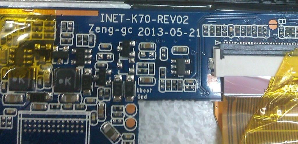

MoveTab Inet-k70-rev02_Zeng-gc 2013-05-21

Model:
Movetab MAQ7DX
Problem:
Hang on logo & few minute bluescreen
Action taken:
Kadalasan nakikita ko program talaga ang solution....habang ng download ako ng firmware,
Try ko muna hardreset kahit walang volume key, aba2x bumigay sya at successfully done.
Ito ang procedure na ginawa ko:
- Power on the tab -
- Connect usb cable to pc -
- Connect usb to tab -
- Press home -
- Press reset button -
(wagbibitawan ang home button, hanggang d lalabas ang factory reset)
or try nyo hold home button and power button
-realese power button pag lumabas na logo then
- Select wipe data/factory reset using touch screen -
