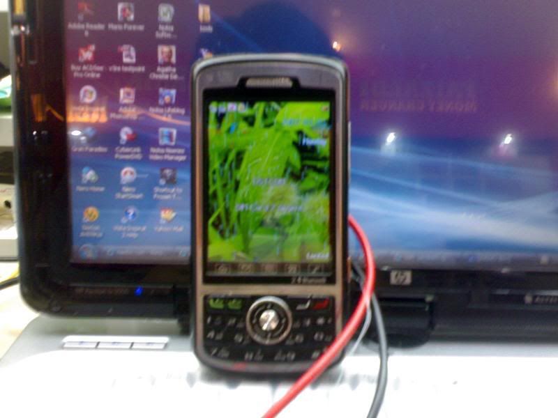

share ko lang to mga bossing MPEG4 P888 with common problem of china phone, auto off with sim card...

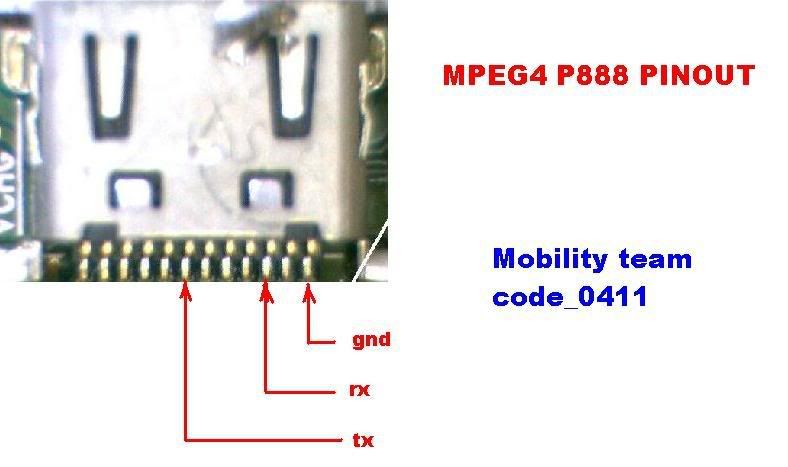

eto po ang pinout,screenshots and logs:

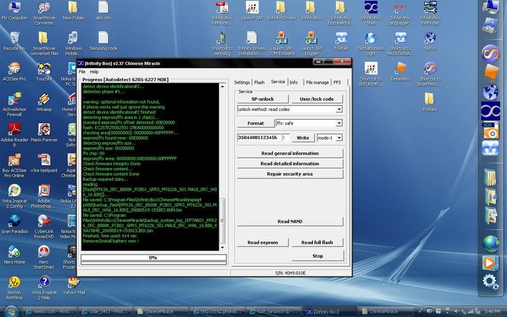

Backup full flash
COM6 [VCP0] selected
Device: Autodetect 6205-6227 NOR
Checking data, wait...
advanced flash detection enabled
eeprom backup enabled, it may takes several minutes !
Action: read NOR flash
Boot...
Press and HOLD Power button now !
19200 fixed
Connecting, wait...
Initializing[6226:8A02:8A01]...
CPU: MT6226
high speed boot disabled
chip: 0031:A741:E9EC
high speed disabled
boot step size: 0002
Release Power button now !
Boot Done
Initialize...
detecting chip #00 in region #00...
flash: EC257E25082501:29EA0000000000
flash: Samsung AMD/Fujitsu std [D 0008x002000 00FEx010000 0008x002000] 16Mb
detecting chip #01 in region #00...
number of flash chip/regions detected: 02/01
Initialize Done
Set baud...
921600
Set baud Done
Initialize bootcode...
Initialize bootcode Done
Check firmware integrity...
device parameters autodetection in progress..
it's time to stop: 290000EA18F09FE518F09FE518F09FE518F09FE518F09FE5
number of flash chip/regions detected: 01/01
total flash region size: 01000000
detect device identification#1...
detection phase #1...
detect device identification#1 finished
identification#1 structure: 2nd [enhanced] generation
security area#1 is Ok
security area#1 backup saved: C:\Program Files\InfinityBox\ChineseMiracle\backup_security\i d.1DF7AB21.[MTK26_05C_B888K_PCB01_GPRS_MT6226_S01.MAUI_05C_W06 _16.BIN_45A15B4E].rpl
New firmware detected:
- make "Read full flash" operation
- send "backup_system_log_..." file to support: mt62xx@gmail.com
- send flash backup file(s) to support: mt62xx@gmail.com
- include in your e-mail full text from phone back label (phone name etc.)
identification#1 detection finished
device-id: 1DF7AB21
identification#1 protocol ver: 04
ver. sw1: MTK26_05C_B888K_PCB01_GPRS_MT6226_S01.MAUI_05C_W06 _16.BIN
ver. sw2: MAUI.05C.W06.16, B1A45EBA
ffs offset/size: 00E00000/00200000
detect device identification#2...
warning: optional information not found,
if phone works well just ignore this warning
detect device identification#2 finished
detecting eeprom/ffs area in 1 chip(s)...
standard eeprom/ffs offset detected: 00E00000
checking area[00000000]: 00000000-00FFFFFF...
eeprom/ffs found near: 00E00000
detecting eeprom/ffs size...
eeprom/ffs size: 00200000
ffs chip: 00
eeprom/ffs area: 00000000:00E00000-00FFFFFF
Check firmware integrity Done
Check firmware content...
Check firmware content Done
Backup required data...
reading [flash[MTK26_05C_B888K_PCB01_GPRS_MT6226_S01.MAUI_05C_W06 _16.BIN]]...
file saved: C:\Program Files\InfinityBox\ChineseMiracle\mpeg4 p888\backup_flash[MTK26_05C_B888K_PCB01_GPRS_MT6226_S01.MAUI_05C_W06 _16.BIN]_20080519-153853.B0M.bin
file saved: C:\Program Files\InfinityBox\ChineseMiracle\backup_system_log _1DF7AB21_MTK26_05C_B888K_PCB01_GPRS_MT6226_S01.MA UI_05C_W06_16.BIN_45A15B4E_20080519-153923.B0X.bin
Finished, time used: 614 sec
Remove/Install battery now !

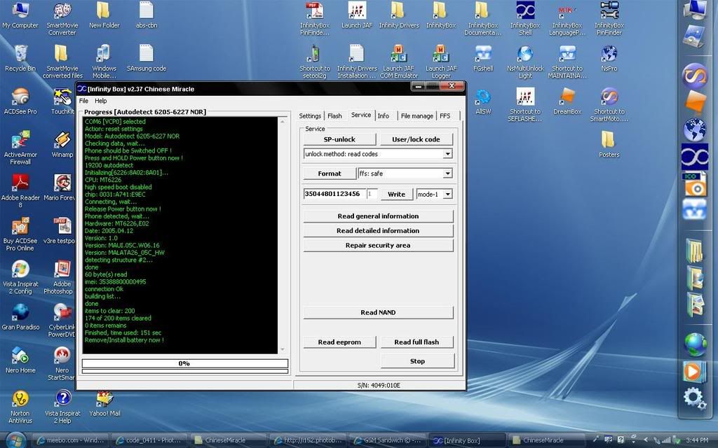

format FFS
Action: reset settings
Model: Autodetect 6205-6227 NOR
Phone should be Switched OFF !
19200 autodetect
CPU: MT6226
Connecting, wait...
Phone detected, wait...
Hardware: MT6226,E02
Date: 2005.04.12
Version: 1.0
Version: MAUI.05C.W06.16
Version: MALATA26_05C_HW
detecting structure #2...
done
60 byte(s) read
imei: 35388800000495
connection Ok
building list...
done
items to clear: 200
174 of 200 items cleared
0 items remains
Finished, time used: 151 sec

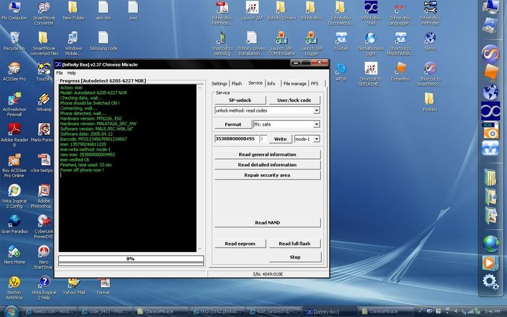

Restore IMEI
Action: imei
Phone should be Switched ON !
Connecting, wait...
Hardware version: MT6226, E02
Hardware version: MALATA26_05C_HW
Software version: MAUI.05C.W06.16"
Software date: 2005.04.12
Barcode: MT012345678901234567
imei: 135790246811220
imei write method: mode-1
new imei: 353888000004953
imei verified Ok
Finished, time used: 33 sec
Power off phone now !
Result
