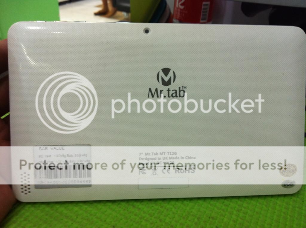

Mr.Tab MT-712G TMPA no ABD/HR [H978_v1.6]rolDONE!

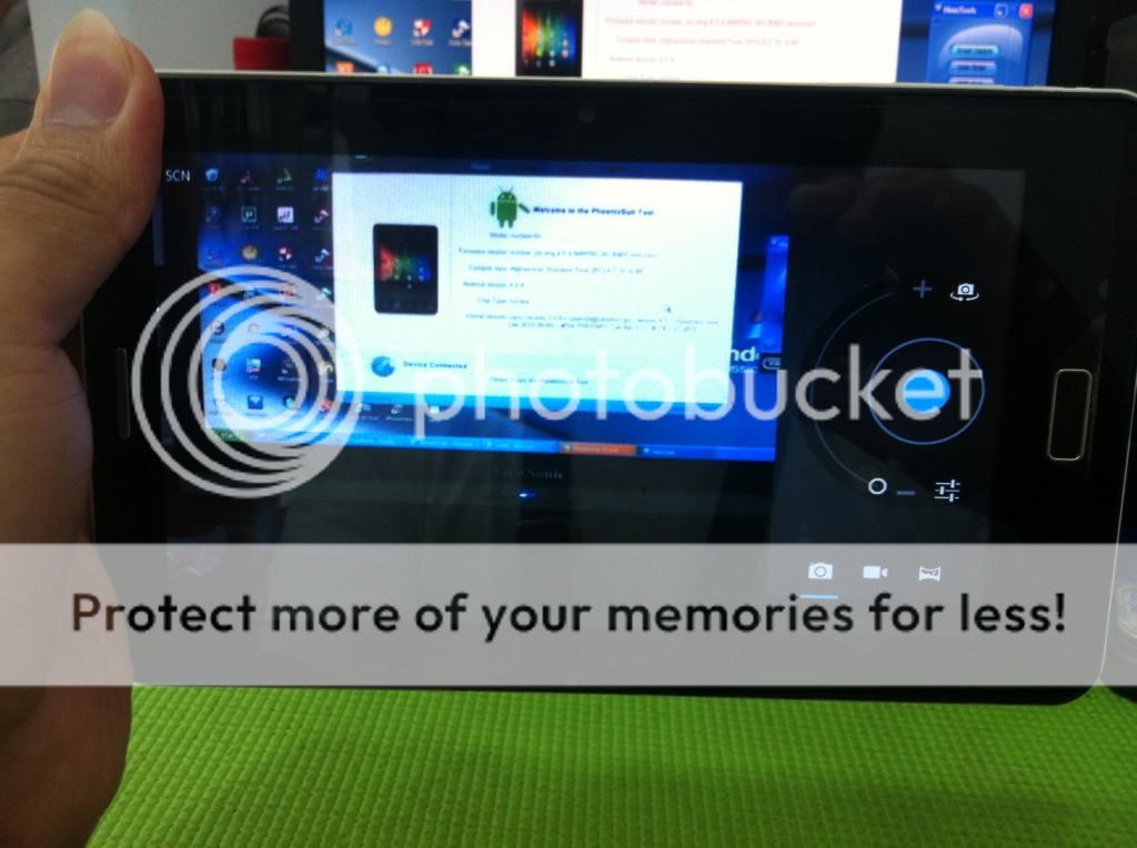

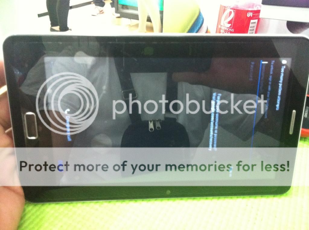

Problem - To many Pattern Attempt

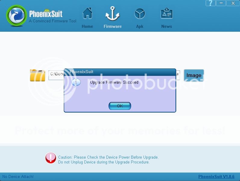

Tool's
- CA-101 Usb Cable
- PhoenixSuit here
- Firmware Tested Board ID H978_v1.6
Procedure
- Turn off your Tablet
- Open Phoenix Suit/or livesuit
- Select Firmware
- Hold Volume + Key
- Insert USB Cable
- Click yes [Does mandatory format]
- Click yes [Are you sure to force format

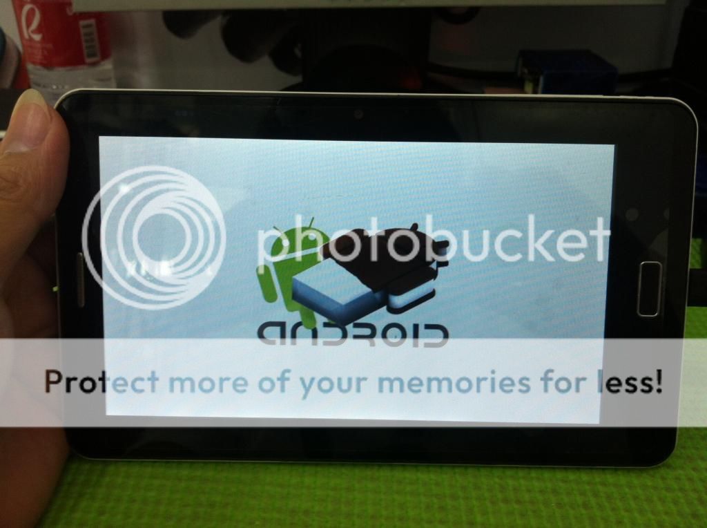

- Wait Until Firmware Upgrade Succeed

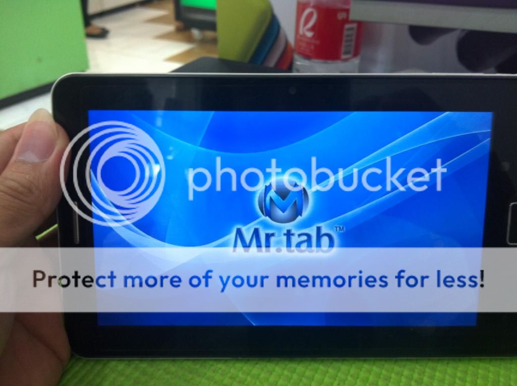

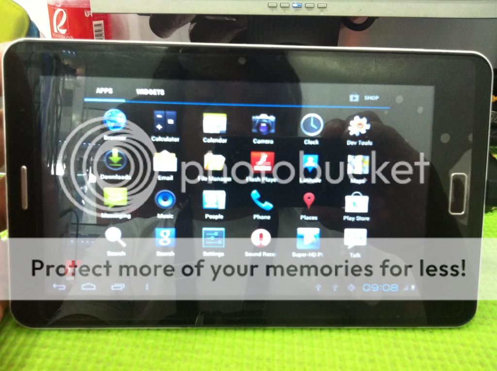

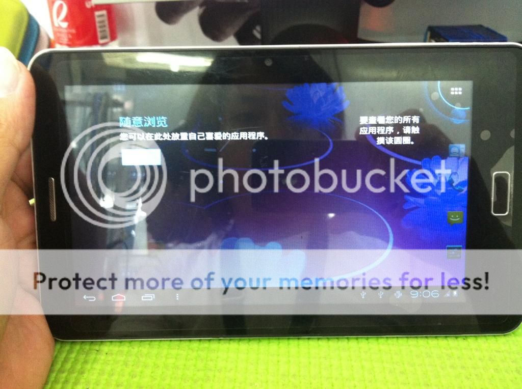

After flash
