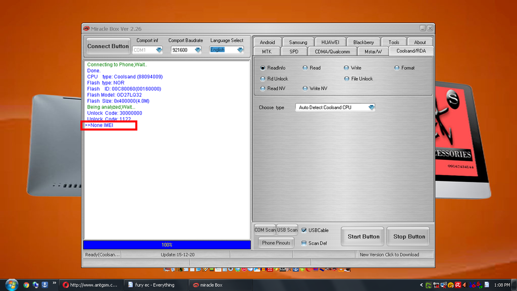

My Phone Fury Eco (Rda/Coolsand 88094009)
PROBLEM
None Imei Result To Failure Call,Recieve And Send Messages.
SOLUTIONl
Open Piranha Crack V1.46
Click Coolsand&Rda
Click Chinese Tools
Tick Repai Imei
Tick Usb Mode
Tick Select Cable Name And Choose Usb (Cable&Mod)
Copy The Original Imei located At The Back Of Your Phone
Tick Start
Insert Your Micro Usb To Phone & Long Press 0
Insert Your Battery And Wait Your Device To Recognize.
(Install Coolsand Usb Driver If Needed)
And Wait...
DONE!!!
