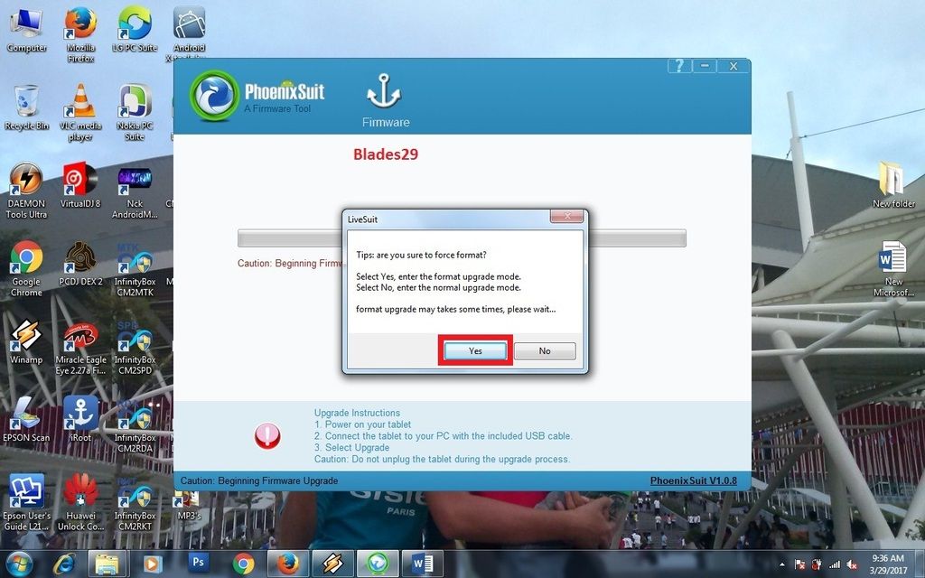

Good morning guys magshare lang po
Eto po ung firmware:https://www.4shared.com/file/QYcv8zWT/sun5i_android_a13-s9060.html
Credit po sa may ari ng firmware
Procedure: 1. Hold Volume up
2. Insert usb cable
3. Press Power Button 5 to 10x para mag install ung driver
Eto po screenshot
Wifi Camera Front and Back working
Done,,,,
2. Insert usb cable
Eto po screenshot
Done,,,,
