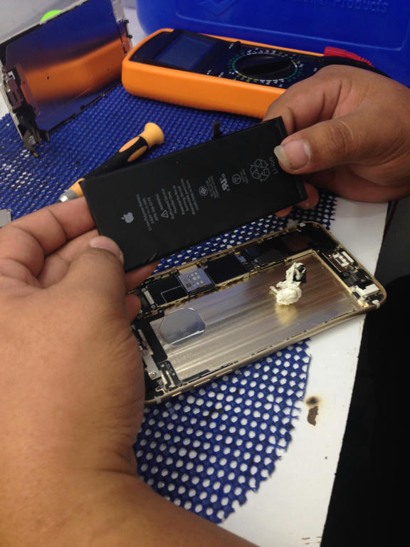

SAMPLE KO PO IPHONE 6 PLUS

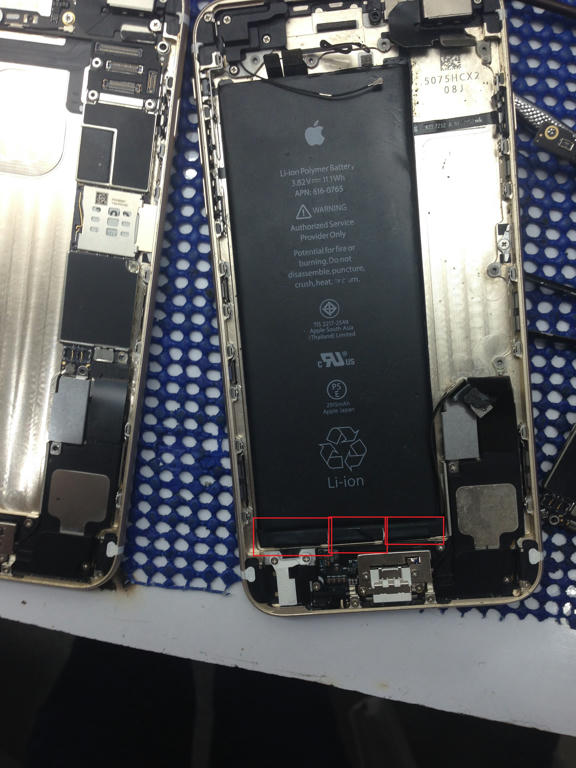

ANGATIN LANG PO ANG 3 NA BLACK TAPE
TAPOS SA ILALIM MAY MAKIKITA PO KAYUNG WHITE ADHESIVE
INGATAN LANG PO PARA HINDI MAPUTOL

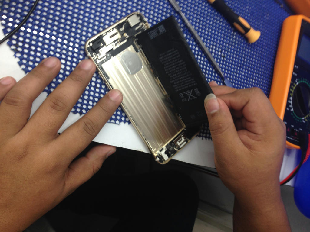

TAPOS HILAHIN LANG PO NG DAHAN DAHAN PAIBABA
KUNG MAARI PO AY ISA ISA LANG
AKO PO KASE TATLOHAN SANAY NA SA PAG HILA
DAHAN DAHAN LANG PO ANG HILA PARA HINDI MAPUTOL
ETO PO PAGKATAPOS
MALINIS PO AT HINDI NA DEFORM ANG BATTERY..
